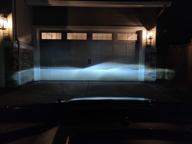

Just wanted to say that I have Depo Euro replicas arriving tomorrow! I'm the one who started the LED thread to encourage people to at least use the very best and cleanest output available but I wasn't satisfied personally... Luckily, I accidentally found a sponsor, the owner of BulbFacts.com, one of the only independent testers of all types of bulbs in both reflector and projector housings. Anyway, he helped with a significant portion for me to order Depo replicas for $350 shipped. They will have taken only 9 days total to arrive from Latvia, which isn't bad, but did take 2 weeks to ship after they ended up needing $17 more for shipping after paying, but I got decent service from Cars245.com. So, they take an H7 bulb so I got an HID kit for them. Surprisingly they say the projectors are for LED, which is strange but HID rules for sure. I went with a very solid budget kit, the DDM Tuning Premium for only $60 but tested out with excellent results. I will likely upgrade the projectors later, so we will see how my ~$410 total investment works out soon! The Depo, compared to the TYC or OEM Euro options do have the LED DRL already wired for Low to be on at all times, but I will also likely do the harness to make true bright for day and dim for at night marker lights, the amber marker in front goes from a combo blinker/marker light to just blinker.
danbfree
3,510
1,203
Tigard, Oregon, USA
#80
Just a quick update, so those can see what you get when you upgrade to the Euro projectors. total investment is $400 including the pair of actually excellent quality Depo aftermarket Euro projectors shipped and after TONS of research, Katana LED's in the Euro H7 format that are only $47. VERY happy with the perfect clean cutoff and the light spread is fantastic for LED's. The Katana's have proven to work amazing in projectors actually originally intended for halogen, but with projectors so much more forgiving to LED's, ones that are designed well are indeed perfect! Even more amazing, the Katana's are clearly a ripoff of the SuperNova V.4 LED's that are $169 but the Katana's are actually brighter in a proper projector! I tried HID's originally and the glare was insane, you have to at least use bulbs attempting to mimic at least the proper filament length of a halogen bulb AND proven to have clean light spread. This was with the bulbs brand new, they are very clearly more white vs. blue now, thankfully, I need to get a new pic but it could be the cell camera even in basic no enhancement mode seems to add blue.. Only downside is with a 100% clean sharp cutoff I did have to watch my vertical aim carefully to get proper distance but not too high as to glare oncoming traffic as they enter the projection area. I need to bring both very slightly horizontally to the right as well for the ECE cutoff to only be on the the side of the road and not back right of cars in front of me.
