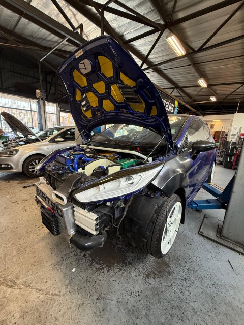

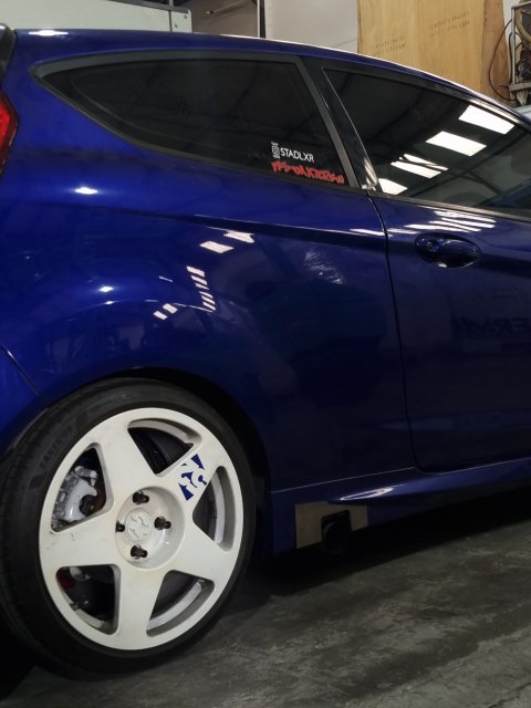

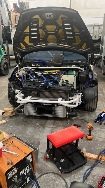

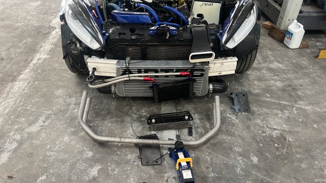

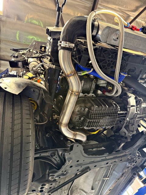

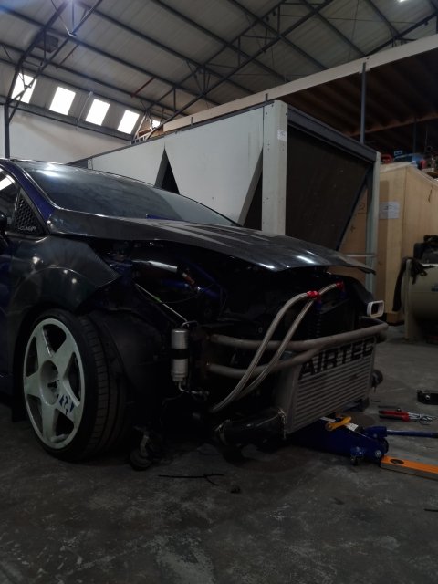

Here are some pics of her from the last week.

Are those half shafts/axles an upgraded (300M??) aftermarket setup, or are they just factory units painted/powder coated/anodized black?
Is that just a stronger and upgraded (higher flow?) an fitted, turbo coolant line coming off of the t fitting on your lower degas bottle/overflow reservoir?
No, just rebuilt & serviced stock CVs

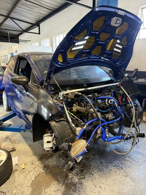

I replaced the plastic T pieces for coolant feed and return on the coolant system with metal ones with AN fittings on them so running full AN lines to the turbo (AN6 in size)
