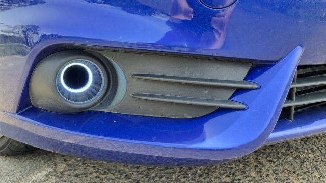

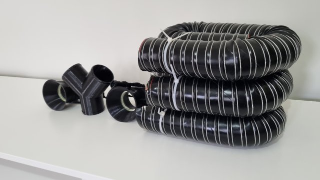

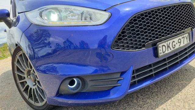

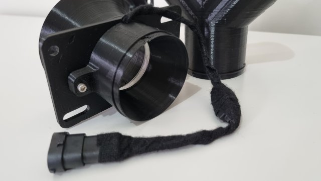

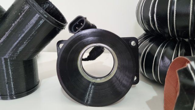

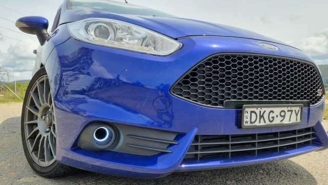

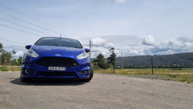

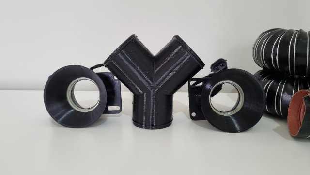

I installed these fog light ducts yesterday.
These are made by RSP Engineering in England and have hoses for brake cooling and Halo LED's so you don't completely lose your fog light.
The prints are identical and I had get the dremel out to increase 2 hole sizes to fit the drivers side, the passenger side fit perfectly but needed this slight mod to fit the drivers side.
All in all, I'm happy as with the look of them and the fact I can now run brake cooling adds some functionality.
The Y piece is to use on the passenger side, split it into 2 and run a hose to the brakes and 1 to the bottom of the Mountune airbox.
I am unsure how these would fit the U.S model.
https://youtu.be/fI4FcBApxS8 View attachment 51820 View attachment 51821 View attachment 51820 View attachment 51821 View attachment 51822 View attachment 51823 View attachment 51824 View attachment 51825
did RSP Engineering address any concerns about the driver side braking having more cooling since it doesn't have a split feed it shares with the airbox? this seems weird to me as general agreement that the airbox is one of the few things that doesn't need more airflow and now it's introducing uneven cooling driver vs passenger front braking.
either way it may not even matter and that's a really interesting option. thanks for posting it.
All the parts are sold seperately so this is a DIY kit I put together from their website.
I figured for public track days, anysort of brake cooling is better than what I have now which is none so I wasn't concerned eith the passenger side sharing the feed with the Mountune box.

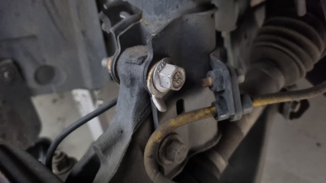

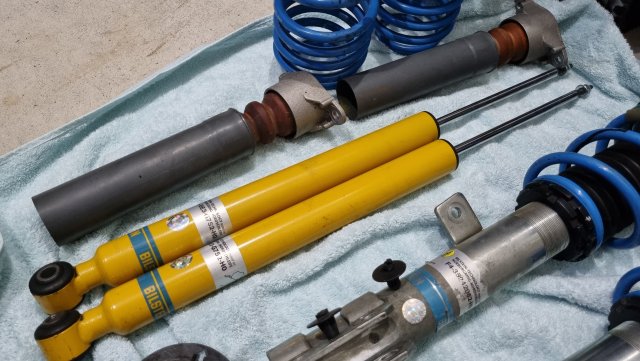

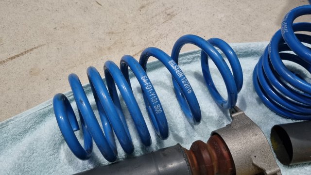

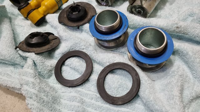

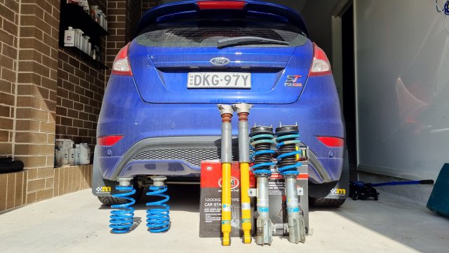

So today was a day.
I had been saving up for some XYZ coilovers brand new. I was about half way there and a set of Bilstein B14's popped up for sale. I had the cash so jumped on it!
I drove over a 6 hour round trip on Sunday and picked them up. Today was the install.
Not too many pics yet, the install itself albeit long is not overly difficult with limited but correct tools. Video to follow.
The biggest PITA was my Whiteline Camber bolts and getting them out. A local Fiesta owner and Ford mechanic came over to help out, much appreciated.
Off tomorrow for a rotation, balance and allignment!
I'll update with more pics once it's all sorted. 20230423_174913.jpg 20230423_174908.jpg 20230423_174908.jpg

Looking good. Pretty sure I watched your YouTube video on the powerflex mounts just a few days ago as well as the info about the camber bolts 👍🏼
Given the new power of hindsight… were the whiteline camber bolts worth it ? I believe you mentioned doing mainly because of rubbing.

Thread Starter #108
Hey mate,
Firstly thanks for watching some vids and keeping up with the progress.
I did get the camber bolts to try and aid the scrubbing which sort of helped but my wheel and tyre combo just didn't quite fit. With the current coilover height I barely scrub at all but I am suspecting the alligner has tried to match factory specs. I think there is a bit more neg camber left in the bolts. I believe if I can get -1.5 to -2° again now with the new height, it'll be sweet.

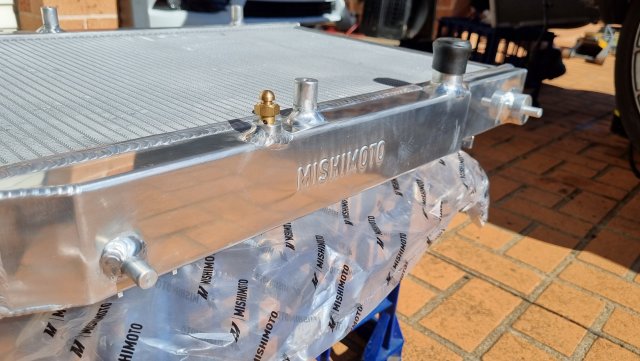

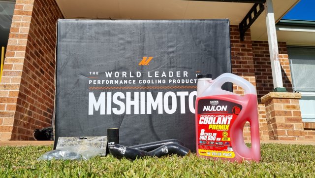

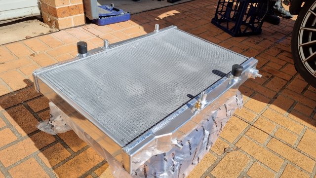

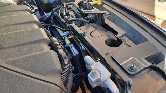

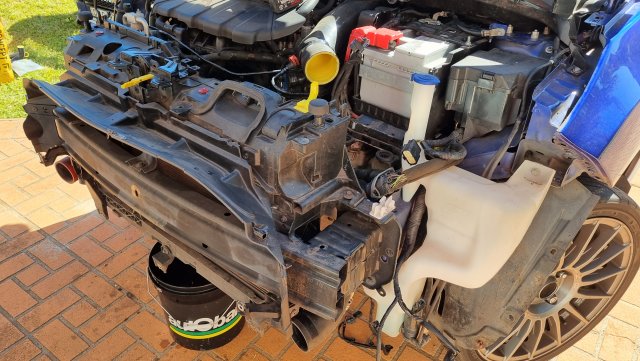

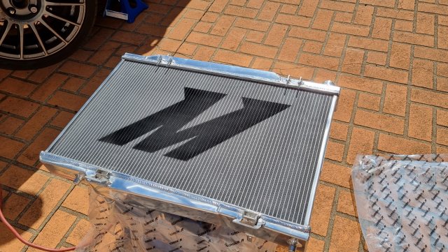

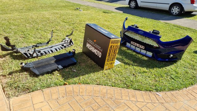

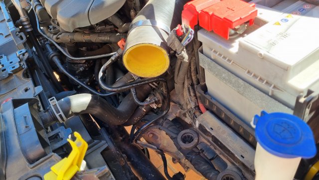

More mods!

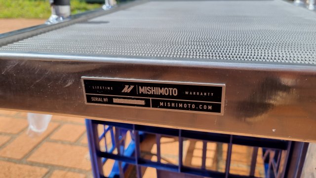

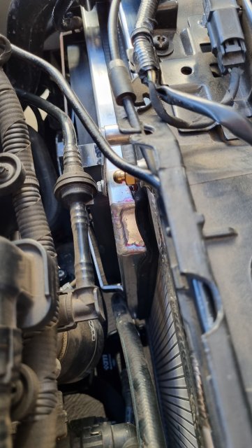

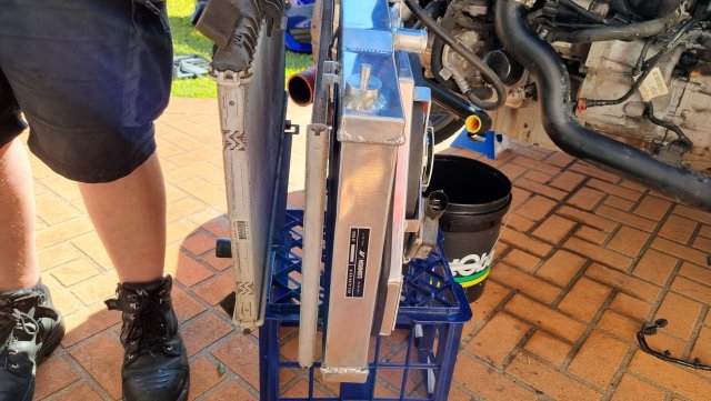

I had the Mishimoto radiator installed yesterday. Video to follow.
The process albeit fairly involved was pretty straight forward. I hired help from Mitch who has done quite a few things on my car now and is a Ford Tech and FiST owner.
Taking off the front bar, the intercooler, crash bar and Then thw radiator pack is easy enough, just takes time. We also removed the airbox (not needed for the job) to make a little extra room for the sake of 2 clips and 2 clamps.
We had to shave one of the 2 little brackets that hold in the air con condensor in at the bottom of the radiator as it didn't quite fit by around 2mm.
Reassembly was fine, again, just time consuming. Bleeding the system was straight forward too using the bleed valve and then the self bleeding Ford system does its job too. I found a Nulon coolant that met the Ford spec and lucky I bought a 6L value bottle as we used over 5L to refill the system with the new triple core radiator.
Whilst we were at it, I fitted the Mountune Silicone hose kit and clamps while we were there.
It's a shame it's all so hidden away as it's a really nice looking unit and for the bargain price of $350AU when Mishimoto had the final sale over here, I couldn't say no. 20230527_112823.jpg
The bleed valve is notorious for leaking and mine did instantly. I have bought another brass bolt to replace it.

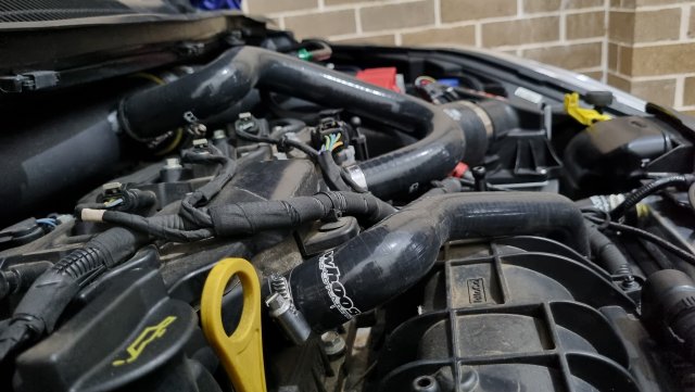

Thread Starter #111

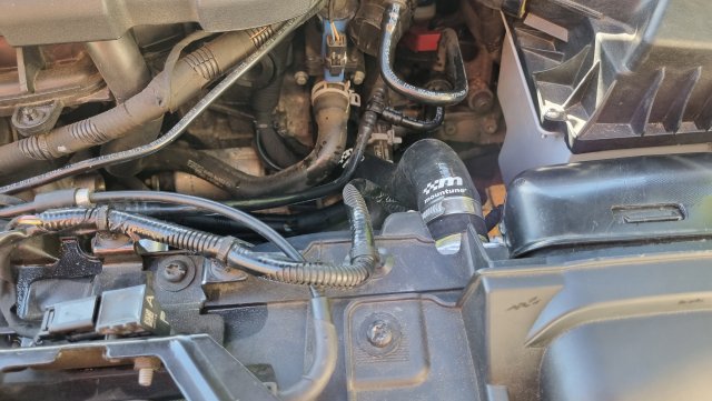

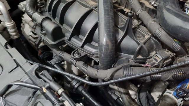

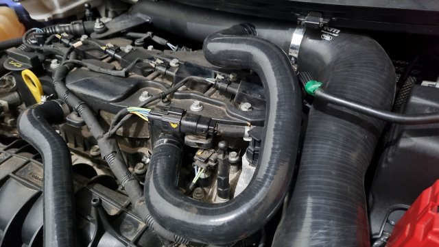

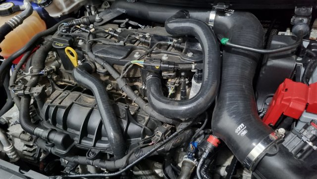

Sponsored video incoming!

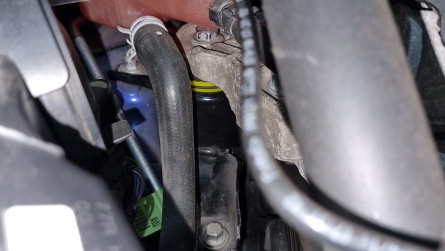

I posted on Instagram a little while back that the oil breather had popped off the crossover.
The good peeps at Whoosh Motorsports shot me a message and said they have a silicone hose replacement. After a back and forth chat, Whoosh said they'd send me the pair to sponsor a video 👍.
The top hose is obviously a piece of piss to swap. Some long nose bent pliers and the hoses pop right off. The bottom hose is a bit fiddly working under the inlet manifold but not complicated, took all of 5 mins.
The replacement clamps that come with the Whoosh kit were a 7mm socket and I also needed a long flexible magnet, that was it.
What I will say is if you wanted to retain the engine cover the hose may need a trim where it joins the crossover. Also it is mentioned on the Whoosh site that for a 16/17 car it needs trimming to clear a sensor. I think this may be a U.S specific thing.
Anyways, video to come but here are the pics. They look great and match up nicely to the Mountune intake hose and Mountune radiator hoses.
20230903_135847.jpg 20230903_135858.jpg 20230903_135912.jpg 20230903_135922.jpg

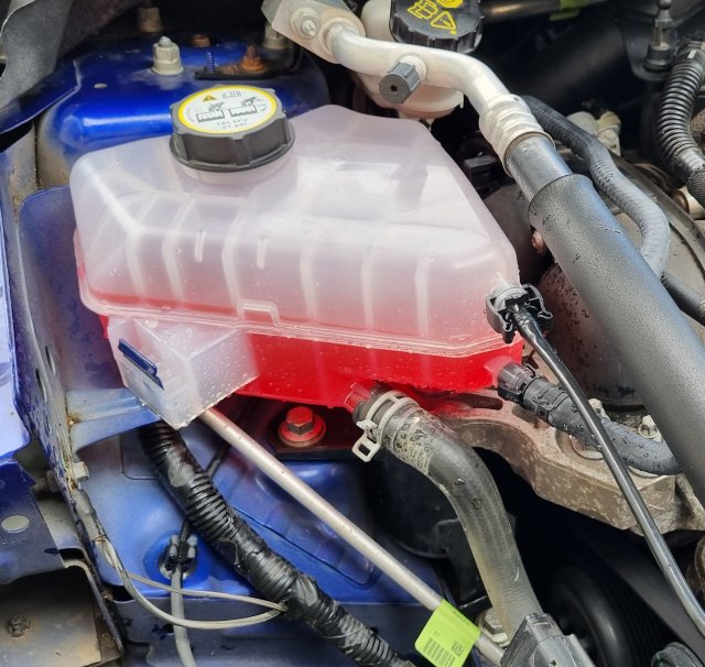

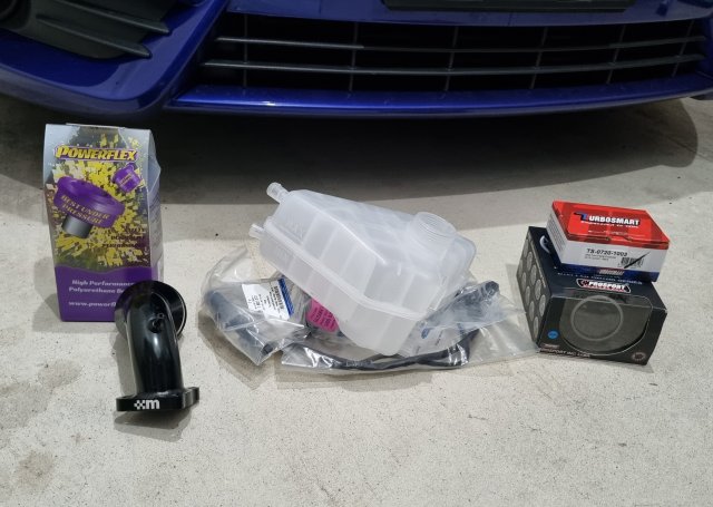

I spent a day with the bro in law the other day.
Successes of the day.

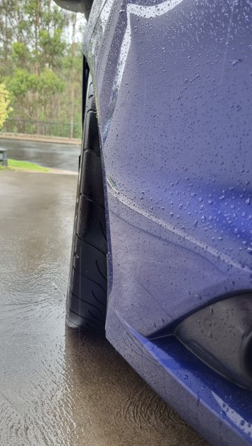

Powerflex purple bushed new rear motor mount added. More vibration yes. Hard to love with? No.
Adjusted the Whiteline Camber Bolts. The wheels haven't scrubbed since. Big win for me.
Also we replaced the expansion tank. Mine was the original since new, had swollen and started to leak, quite a bit so that went out and the new one in with the 2 thin lines replaced for new also. All shmicko now.
The fail of the day was the Mountune turbo elbow. I think my Whoosh silicone reducer from the Whoosh crossover is only good for the stock sized turbo elbow. The silicone join just wouldn't fit at all so after fitting it to the turbo, it had to come out and returned to stock. What a f**k around that was.
we didn't get to the boost gauge unfortunately.

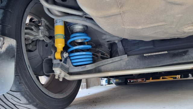

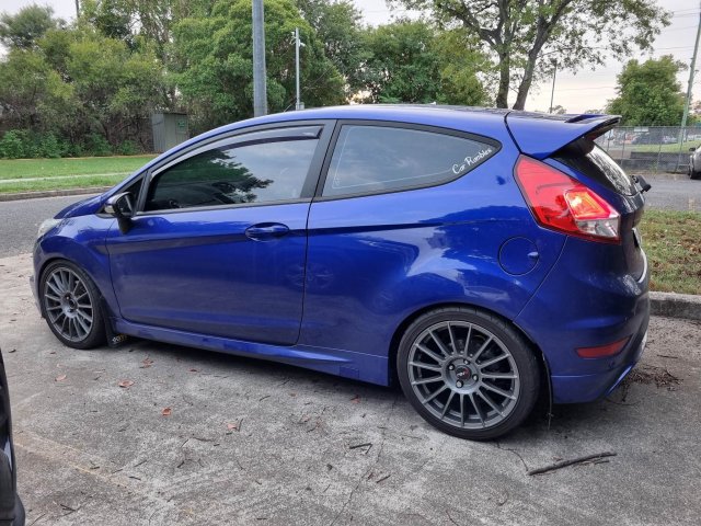

486
379
BC, Canada
Pics of how it sits on the Bilsteins. No adjustments needed!
Very nice, those pictures kind of make me want to go back to 17" rims.
Small question for you, do your rear springs make any noises from time to time at all? Like maybe a twang on certain dips or when the car is coming out of a sharp turn?

Thread Starter #114
No they don't. I haven't got any weird noises. I know with some coilovers if the pretension isn't set right or there are no spring dampeners it can cause those noises.
