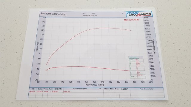

I had it on the dyno the other day and it was consistently reading pretty low for all cars, Focus RS/ST, Fiesta ST, Volvo C30, BMWs etc.
The result was 127.5KW at the front wheels where you would expect 140-150 on other dynos.

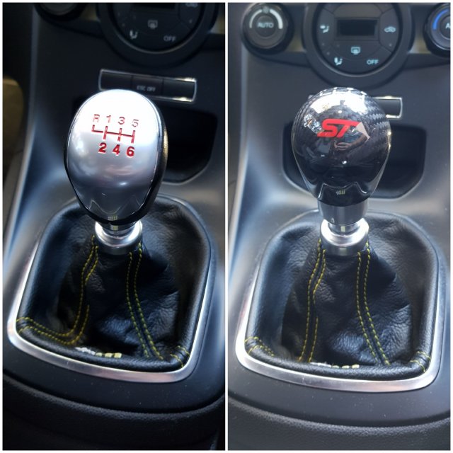

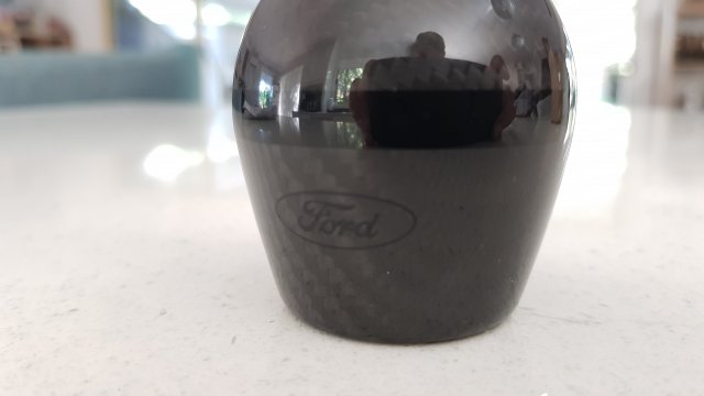

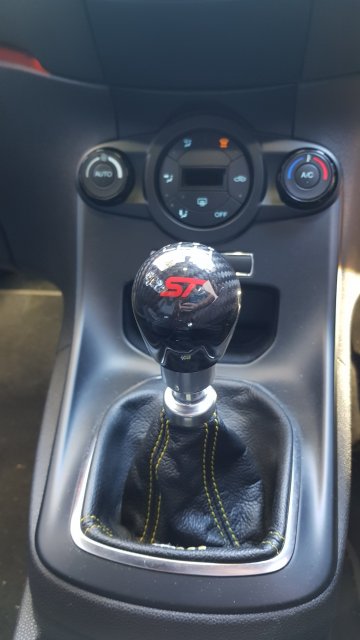

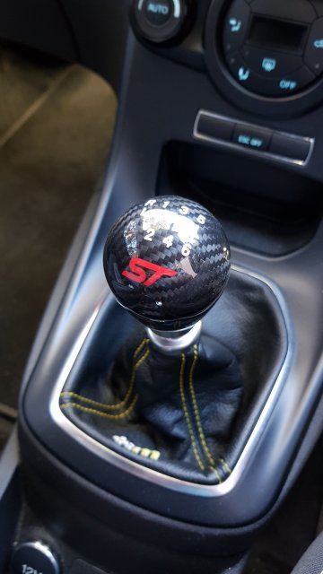

I also finally bit the bullet and bought a Ford Performance carbon gearknob and fitted it.
It wasn't cheap but very happy now I have it.

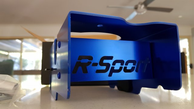

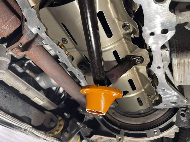

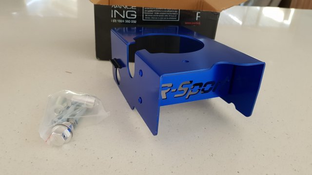

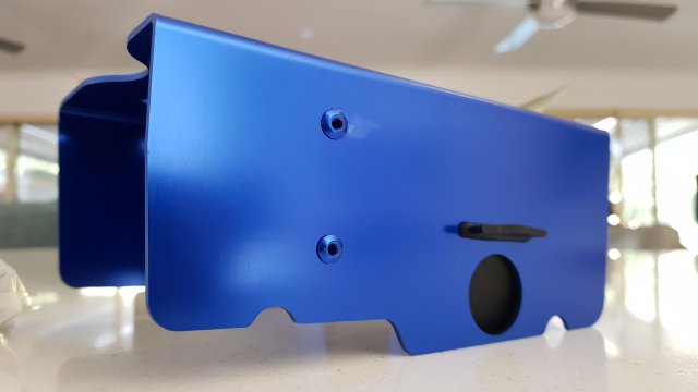

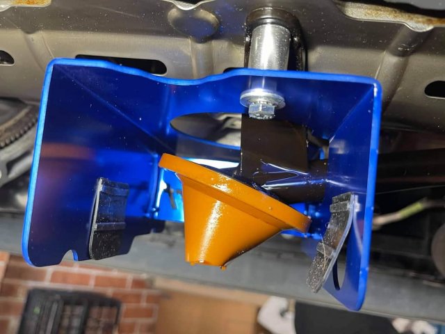

Also bought a sump baffle and magnetic sump plug from Pumaspeed in the UK. Hopefully these are a good functional design and will help prevent any possible oil starvation issues on track. 20210602_110606.jpg 20210602_110610.jpg 20210602_110648.jpg IMG_20210612_200139_451.jpg IMG_20210612_200139_471.jpg

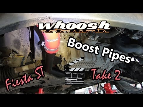

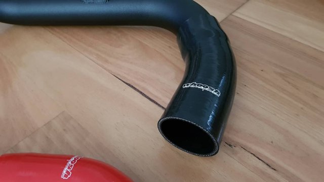

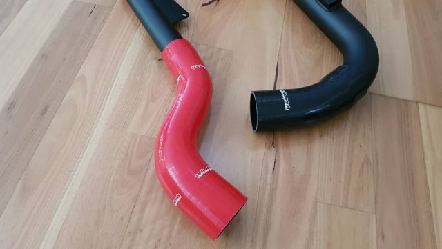

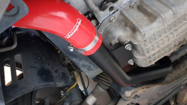

Another good addition is the Whoosh Motorsport Boost pipes hot and cold side.
After the absolute ball ache I went through with AET Motorsports and their "premium kit" not fitting and not only no accountability from AET but blamed me for them not fitting (like I fucking designed and made them myself 🙄), the Whoosh Motorsports pipes went on very easily and measured up beautifully 👌.
IMG_20210520_082502_546.jpg IMG_20210520_082502_554.jpg IMG_20210520_082502_559.jpg IMG_20210520_082502_562.jpg IMG_20210614_171943_683.jpg IMG_20210616_080005_429.jpg
Youtube video here for the boost pipes:
View: https://youtu.be/AKrO5C5f0Wg

The sump baffles definitely help a bunch.
But if the g forces get high enough, a dry sump system is needed, or at the very least an 'Accusump/Engine Oil Accumulator' type device on a wet sump system. [wink]
14,762
7,232
#72
Correct, as you'd have to be on soft compound full race slicks with full 3 way adjustable suspension, perfectly dialed-in, and all of the other suspension mods in order to be anywhere near the gs which would require a dry sump.
Hell, even the R5/'Rally 2' FIA WRC cars are NOT allowed to use dry sumps, and they are fully sorted for tarmac use with full suspension, and sticky tarmac tires.

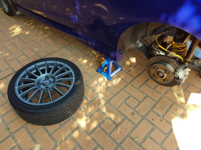

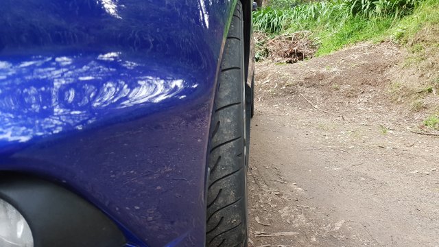

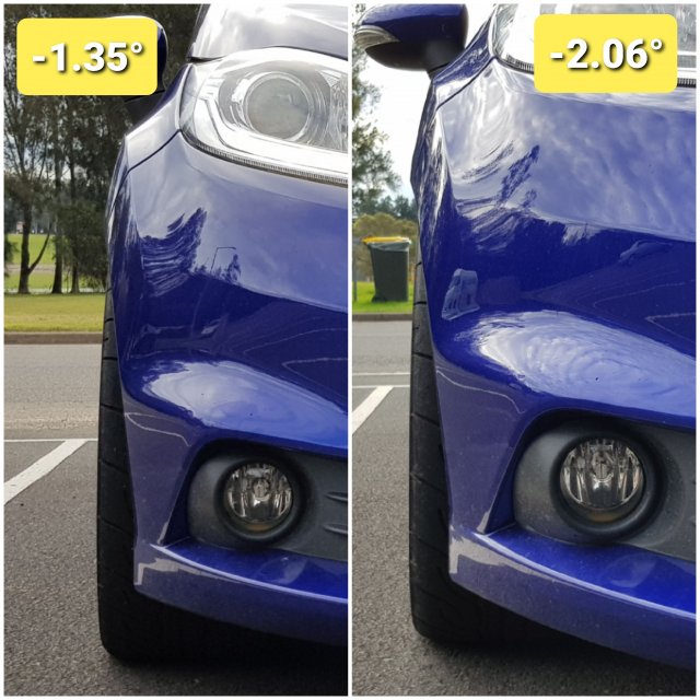

I had the Whiteline Adjustabel Camber Bolts installed when the sump baffle went in.
I ended up with just over 2° neg camber and the scrubbing is pretty minimal now. Having said that the side of the tyre copping has a nice groove lol. I imagine when I rotate the wheels it will pick up a bit too.

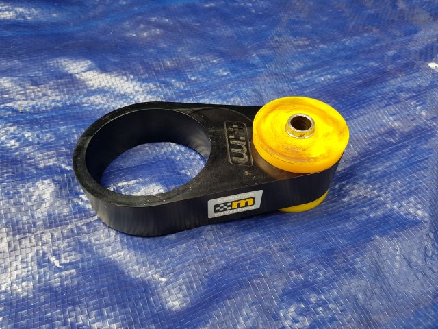

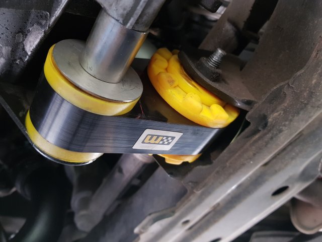

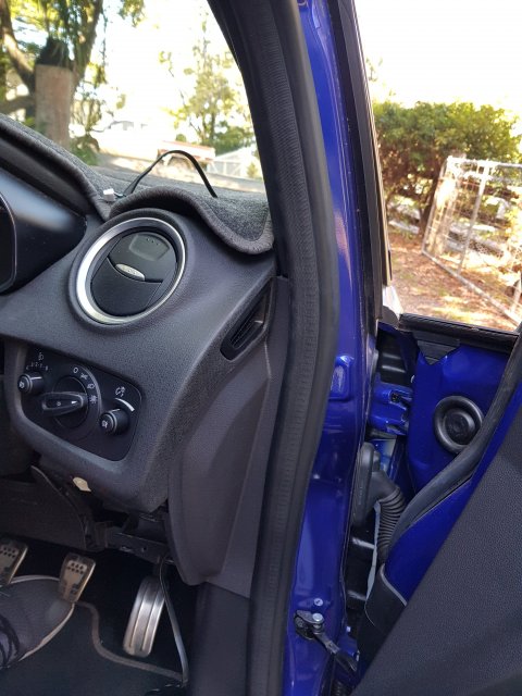

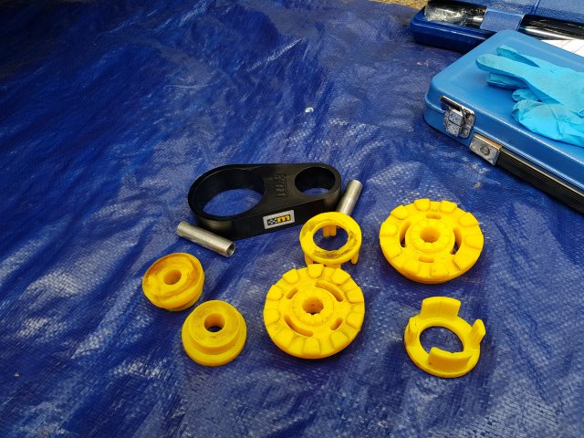

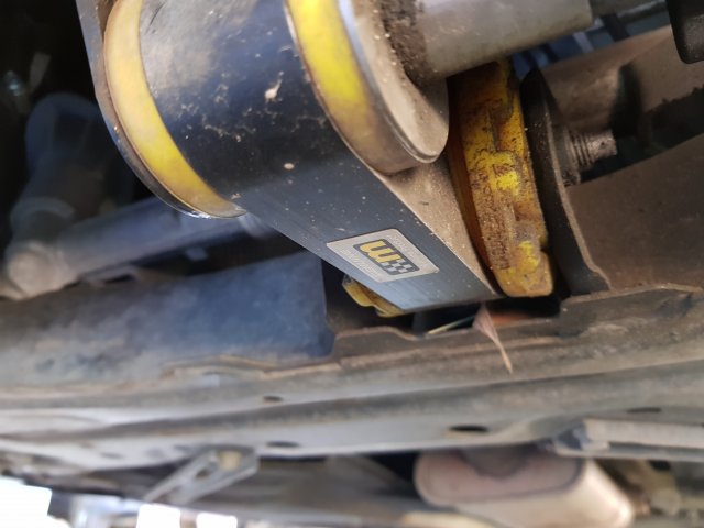

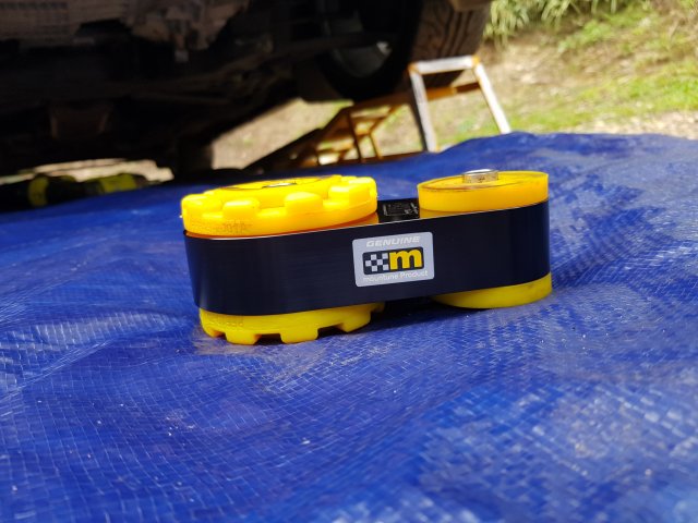

I thought the Mountune (UK) engine mount was starting to fail (see first pic). I got in contact with Mountune who, with a decent response time asked for photos which I sent pics of the mount still installed. They asked for photos of the actual bushes (fair play to them really) so today, I had the mount off and all pulled apart. The Powerflex bushes are in great condition still and no signs of wear, splitting or anything. Over 2 years of daily driving, 2 nights at Sydney Dragway and 3-4 track days.
It was interesting pulling them all apart, cleaning it up and reinstalling.
Now........ Do I get more firm bushes for it??? Hmmmm.
One of the original pics I sent to Mountune. Seeing the bushing pushed out had me worried. 20210821_145343.jpg
All apart and cleaned up, ready to be put back together and installed.
Aaaaand back in the car, torqued to 48Nm. Will torque them again in 100-500km of driving.

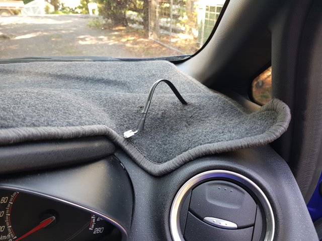

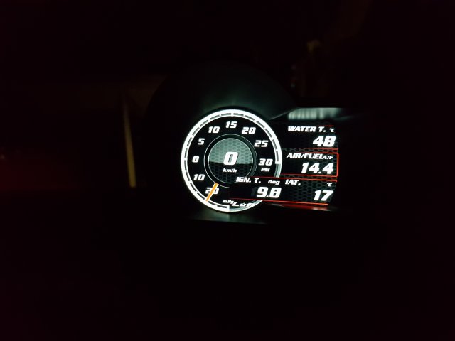

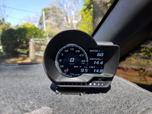

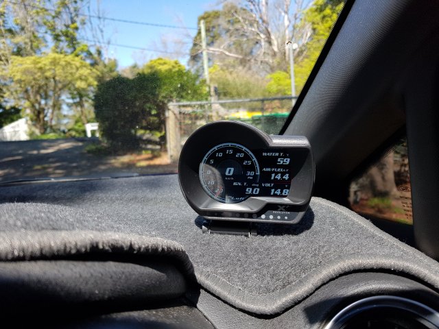

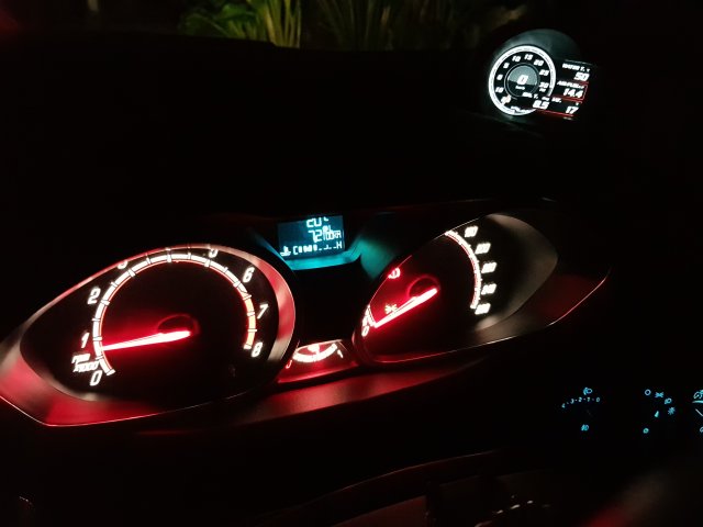

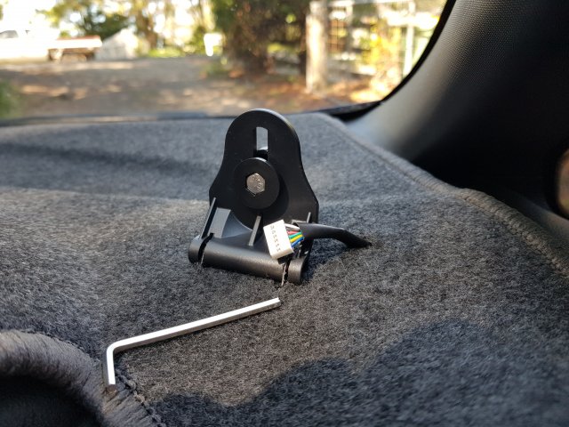

New Lufi OBD II Gauge install and first thoughts video done.
Initially it's not too bad, as long as it is fairly accurate. Pending your car make and model this will read from the factory sensors so I can see things like coolant temp, AFR apparently, intake temps. What I can't see which I wish I could are oil pressure and temp.
I'm also not confident the gauge reads to 30psi as it shows on the screen as it seems to have a sharp consistent cut off at 22.5psi of boost (read from the map sensor).
Something to keep an eye on during track days.
View: https://youtu.be/zmvYxURQ-dI 20210907_153054.jpg 20210908_112300.jpg 20210908_113022.jpg 20210908_113852.jpg 20210908_121036.jpg 20210908_190643.jpg 20210908_190701.jpg 20210908_121055.jpg

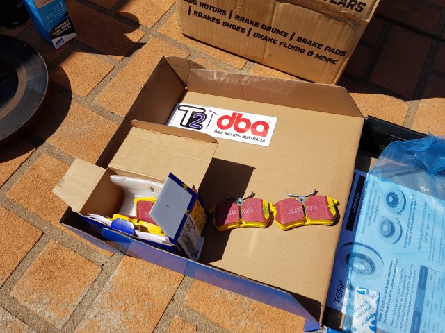

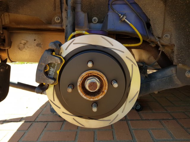

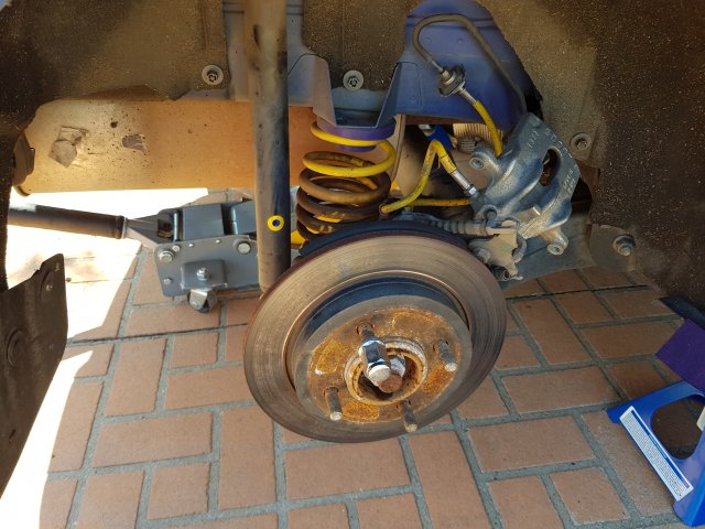

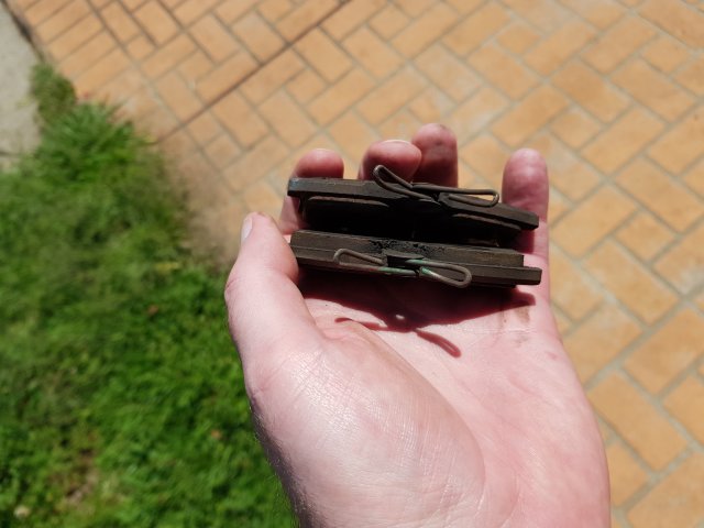

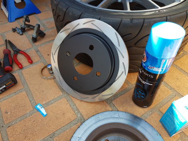

No video for this one but today I had the rear brakes replaced. The stock pads were 72,xxx km old and had seen 4-5 track days. The discs were still good but replaced anyway.
I bought a full set front and rear of the EBC Yellow Stuff pads. After inspecting the Forza Brakes FP3 pads which have been amazing they still had a fair bit left so decided to leave them on. The front Yellow Stuffs will go back on the shelf until needed.
Rear Yellow Stuff pads and DBA T2 discs installed. The T2 is a solid disc but is slotted. Will be an improvement for the rear.
Run in will be to drive sensibly for a few hundred km and then do 8 fairly solid 100-40km/h stops and then let them cool.
Track day run in is to then go a little faster and brake harder to 40km/h then pull over to let cool completely.
20211023_100159.jpg 20211023_100212.jpg 20211023_101024.jpg 20211023_101041.jpg 20211023_103641.jpg 20211023_103814.jpg

Yes they make a T3 4000 series vented and slotted disc. I have them in the front.
I tried pricing out what these would be sent over to the states through DBA USA, and it was well OVER $1K USD for the set of four, and a possible half year+ wait time!! [crazyeye][ohcrap]
They are great, high quality rotors, but for the same price as Ron's front BBK, that's a NO GO for me.
So I just ordered Ron's Brit cast, 'j hook' slot set for less than a third the co$t of the DBAs. [wink]
