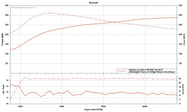

Here are some of my most recent virtual dynographs on aux fuel.
v4 (4th gear, 93 octane, Stratified 4-port aux fuel)

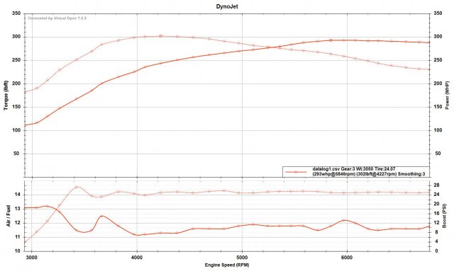

v5 (3rd gear, 93 octane, Stratified 4-port aux fuel)

Very nice. My tuner didn't want to push anymore then 25 psi up top on 93 as I was getting knock. He say he was gonna push it any further boost wise?
I just sent this to Mitch, so not sure yet. There was some significant knock up top on that latest vdyno I just posted so I am likely almost there on 93 octane. Just tighten up that AFR line. I have the bigger 95 lb/hr injectors which are tougher to tune for since they are oversized for 93 octane.

Yeah most likely he will just further adjust ur fuel and ur charge temp compensation tables. I was getting alot of knock up top even in colder temps and my charge temps were shooting up 20+ degrees. May switch up my intercooler at some point (whoosh v2).

I may do that as well. I have the CP-E FMIC and am seeing a 15F rise over a fourth gear pull.

The whoosh v2 and the cpe are the same exact intercooler lol that'd why there is a v3 now with different end tanks. I'm gonna get a bap if I upgrade but we will see how ethanol helps.
