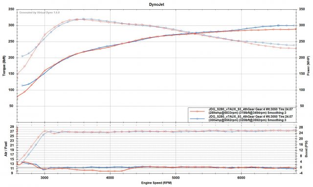

Revision v7 w/ aux fuel (93 octane)
The spool is insane. AFR look much better but still seeing knock. Need to investigate this BA intercooler.

looks great! you think the knock is from heat?
I think it’s a combination of the added heat and not enough octane. The knock will go away on ethanol I’m nearly sure.
@MagnetiseST sent me a log and with the BA intercooler he sees an 11 degree rise in charge temps. I see about a 15 degree rise during a similar pull. He is in Florida though so definitely an improvement over my FMIC.

I think its mostly just the octane at this point. We're both at the limit of 93. It stinks these cars really don't like pump gas but it's a low displacement motor that's not super high in compression so you have to run a ton of boost.

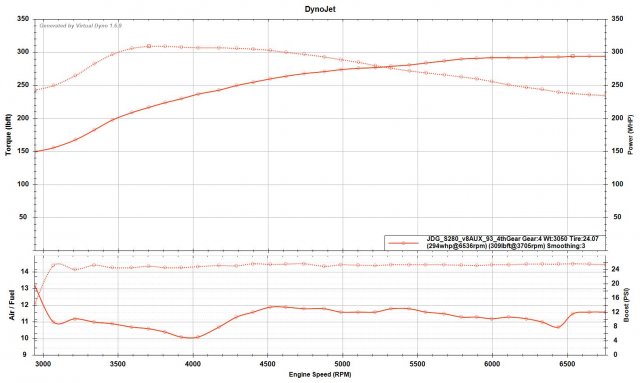

Back on topic. Nearly complete for 93 on 4-port aux fueling. Took a bit of boost out to control knock. This revision has virtually no knock. v8 Aux VDYNO.jpg
Curious on whether my tuner will pull boost or pull timing. I am hoping to run 30psi.
