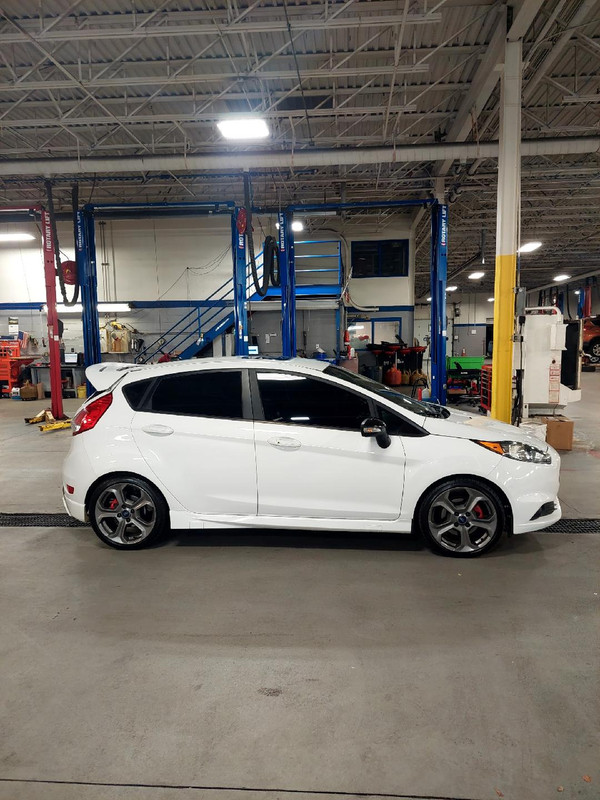

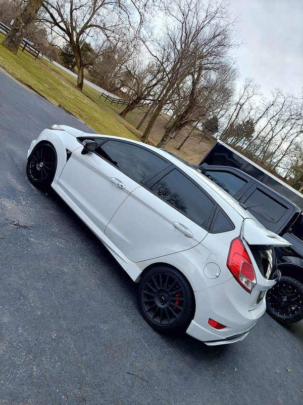

welp boys and girls, my journey with the Fiesta ST has ended. After the Fiesta commercial i couldnt part with it but didnt know what to do. it was sitti g and i barely drove it, just enough to get fluids through it.
after a chat, and an hour drive, giving it my laat thrashing in my hands, I dropped it off at my brothers. place. He has taken delivery of it and in the last 2 weeks has been working on getting it back to shiny and all fixed. he wanted a daily beater and this fit the bill.
i gave it over with 178k on it, and in a month or so it will start racking miles up again!
pics he sent me of the resto :)

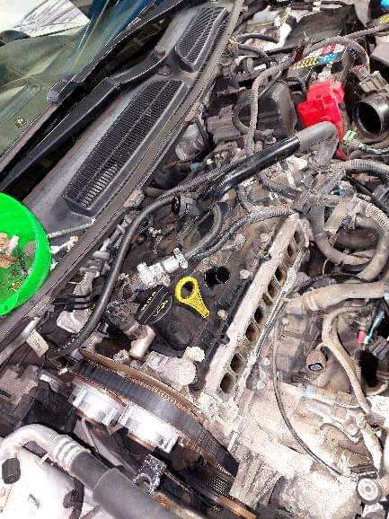

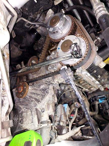

progress...
he found Good Rado gray ST wheels for it last week so its back to stock look.
Timing belt
Water pump
Thermostat and housing
Knock sensor
Tensioner
Trans fluid change
New coolant
turbo oil feed line was almost off so they put anew one on the tech had as a spare. all work done by my bro and his Ford Tech buddy per manuals :)

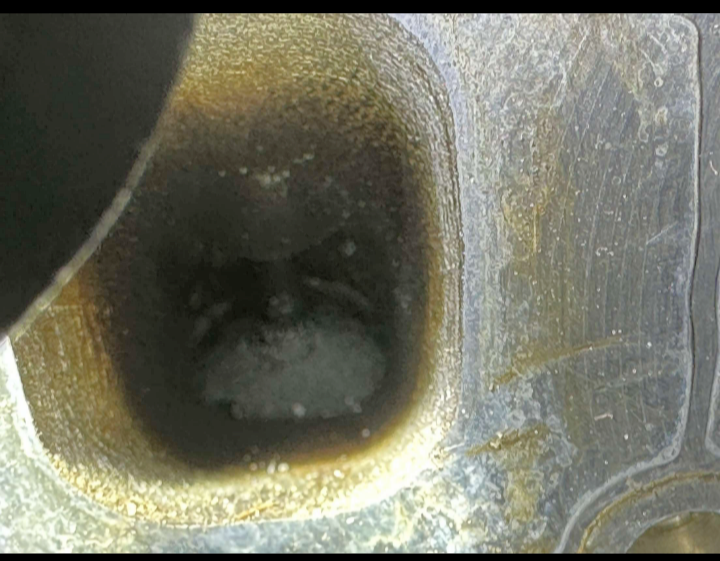

valves are pretty clean for 178k! no catch can as it never picked much up so i removed it.

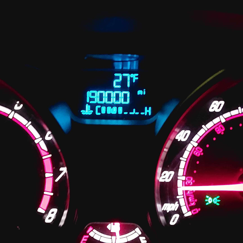

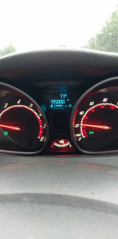

The FIST is now @190k miles :)
My bro dailies it. Been doing great. He said he had a lil coolant leak somewhere at the junction by the tstat housing when it was really cold out but it kinda went away.
It's still on stock everything in the motor, except I did plugs once, timing job was done. There's a slight VC oil leak, apparently that's a nightmare job to redo, since they GLUED IT ON :/.
I got him new mountune springs for Xmas :). Sitting back as it was.
