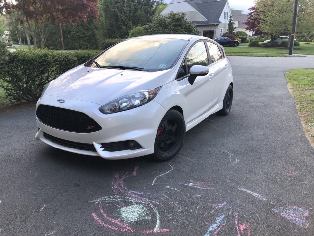

Hello all. I just went to a 205/50/16 on my slipstreams. This is a great setup for me as it is my daily commuter. The suspension is stock. (The photo came out pretty cool with the kids chalk work.)
HOLY BEGEEZUS... Someone stop that guy... He stole my car...lol. Our tastes are very similar. I have 205/50/16, and they feel 1000x better than the 205/40/17 stockers.
