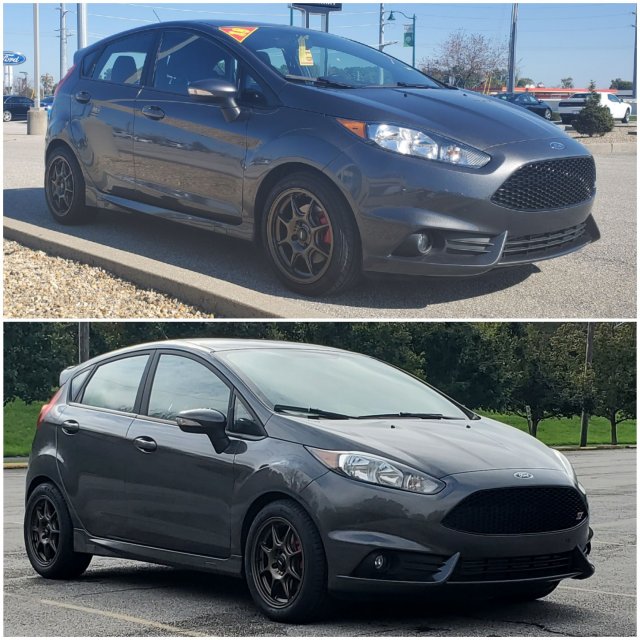

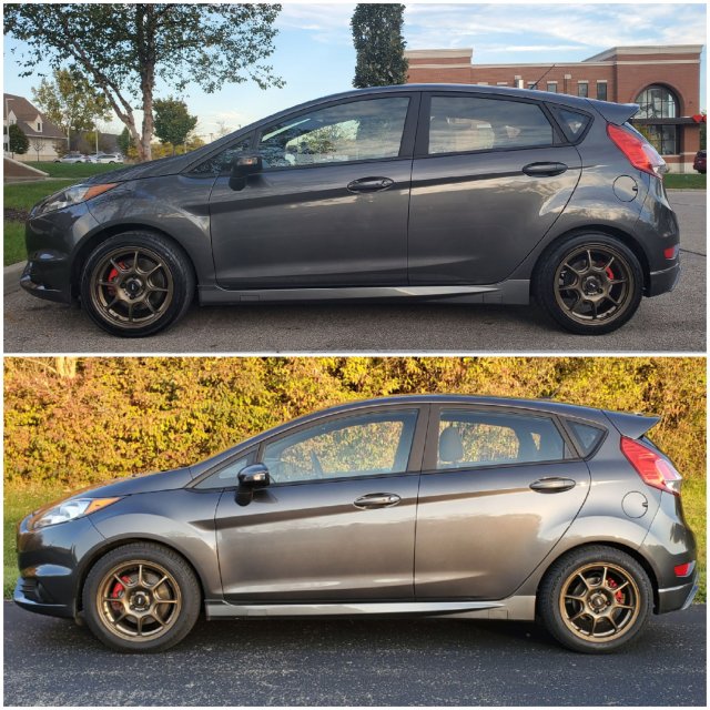

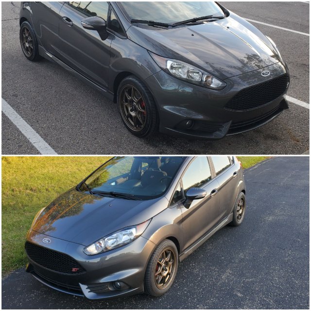

I recently bought a Fiesta ST that already had 16" wheels and 205/45/r16 tires on it. To my eye, the 45s looked a little small and this thread was one of the first I came across looking into it. After reading through it and a number of others, I became convinced that I wanted 50 series tires and so here are the results. I hope it will be a beneficial addition to the thread -- here is 205/45/16s vs 205/50/16s on the same car, stock suspension.
I am very happy. I think the 50s fill the wheel well much better, the beefier look is much more aggressive (this is actually hard to capture in pics compared to in person) and the ride is improved. Recommend the 50s to anyone on the fence.
View attachment 44639 View attachment 44640 View attachment 44641
I agree with the 'look' of the 205/50s, and yes, with the extra side wall cushioning for use on destroyed roads.
I even have 205/50s on my Dekagrams for daily driving.
But therein lies the 'rub' (to make a pun), as that W-I-D-E for it's 205/50 size NEO GEN on my 40ET, 16x8 wheels DOES just that (rub) at times, under certain conditions, out on the roads, yes, even on the fully factory suspension and ride height, and a lightened car.
I am seriously considering running 205/45-16s next go round if I even decide to keep these wheels, despite the 'jacked up' rough tarmac rally 'look', unless someone releases an UHP all season in a 215/45-16 size (almost a half inch shorter than the 205/50s, but still a bit taller than the 205/45s), which is highly unlikely.
Your setup may not rub because you are using a narrower 205/50, on a 7.5" wheel (not sure of the offset on the Lockouts [dunno]).
