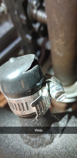

I am on my fourth revision, (rev. d) and things are great. Car runs great and pulls strong once I hit around 4000 rpm it really takes off. At this point I'm hitting around 26-28 psi. The only issue I'm having, which has nothing to do with the tune, is that the nylon cap I'm using to cap off the bov port that is on the atp hot side pipe keeps tearing from the boost build up Snapchat-1273642287.jpg
I found a silicone cap that is supposed to hold 5 bar so hopefully that will hold or I'll have to weld it.

WHY I put an expander plug in the factory pipe symposer outlet, and THEN put a Sure (same as Ron's whoosh product, but he did not offer them way back then) thick silicone cover delete OVER that (yup, even on just factory snail/boost). [wink]

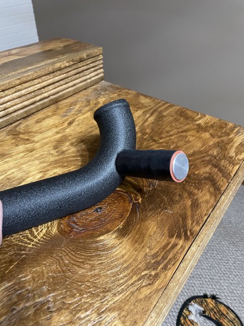

I ordered a 1” plug from ATP alongside the turbo kit and used it with a short piece of 1” silicone to block that port. I have an extra one you can have, would just need to trim that 1” elbow that ATP provided. Works like a charm. Pic below. There are hose clamps on there now of course lol.

I'll let you know how the silicone cap that I ordered goes. I blew out another nylon one last night so I doubled it up and that seems to be holding for now. Def find myself trying to race more people now lol
