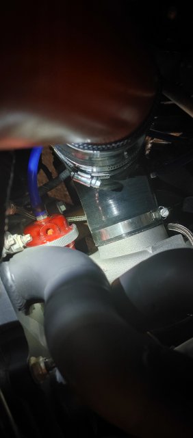

So I drove the car last night on dizzys base tune and hit 30 psi. He wants me to check the boost solenoid plumbing. I was pretty sure I got that right but we'll see
Definitely check the solenoid plumbing. Also check that nothing is interfering with the IWG actuator rod preventing it from fully pushing the gate open

I could have sworn I got the plumbing right, double checked it before I put it on, idk very annoyed.

100% found your issue! Lucky you only hitting 30 PSI with it like that, could have easily been much worse.
Yeah I did a small pull to about 5500 after work last night then I looked at my ap and saw 30 psi. Kinda freaked me out but the car took it like a big girl

Let me know if Tial says it's going to take a while to get you a new plug. I don't have the tial installed so could pull that plug from it and send it to you to get you up and running faster. Would just need the replacement so I don't have a tial paperweight for when I go to sell the 2860 kit
Thank you sir but I have already ordered a couple of tial plugs from some website.
