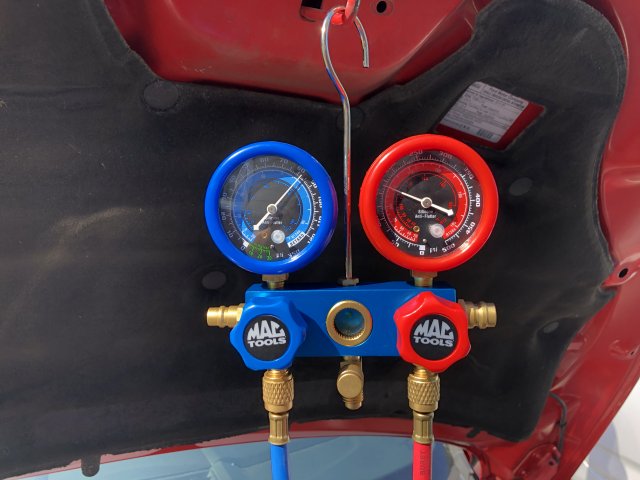

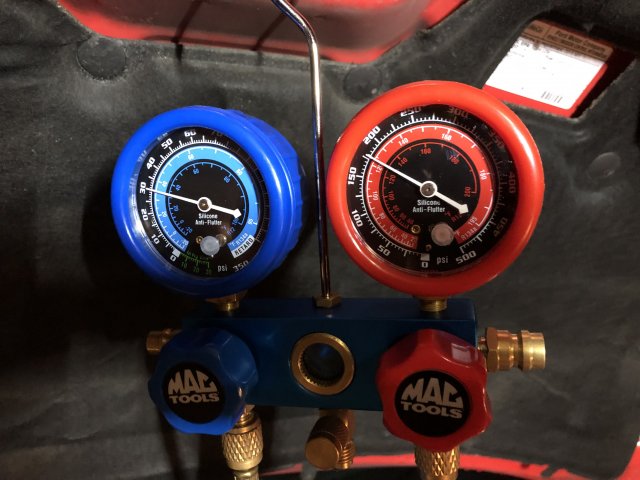

Sometimes the ac will work perfectly while I’m driving and then it’ll just blow warmish air. I’ve been having this issue since last year, summer time, but it never really bothered me enough because I work nights and it usually doesn’t happen during colder temperatures. The ac clutch will be engaged but still blow warm. Usually happens after stop and go traffic on hotter days(above 80ish degrees Fahrenheit). I’ve attached two pictures to show when the ac is working and when it is not. I’ve haven’t checked to see how much Freon I have but I don’t think it is a concern due to the ac getting really cold when it’s working.

Is it holding steady at 30 PSI I see it that one picture? or is it going down then back up down and back up?
I assume the coolant fan runs when the AC is on.

It can be undercharged or over charged. Have you ever yourself put Freon into the vehicle?

If I remember correctly it’ll go up to around 40-45 and then back down to 30-35. The cooling fan does come on and stay on. Also no I haven’t tried to add or remove Freon.

This is what I would do put AC on full blast with all the doors open. It should hold steady at whatever PSI let's say 30 if it's going from 30 to let's say 45 and back down to 30 and then back up 45 and it's repeating that cycle that's a sign of low refrigerant.
By looking at your high pressure side you are definitely not overcharged.
I don't know about the issue with the hoses getting a kink in them, but if that is an issue that could also be problematic.
