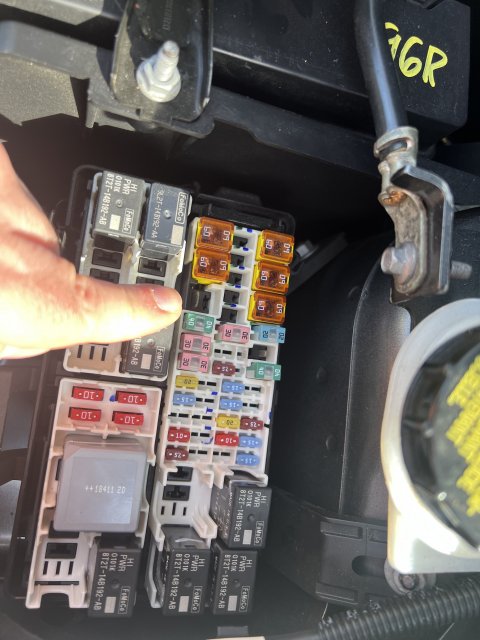

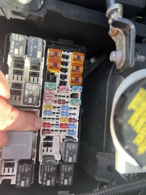

Noticed that the AC is not working and in attempting to check the fuses, I’m not so sure that I’m tracking the diagrams I found online.
Found the 10a, which is the compressor clutch, but where I expected to find the 60a fuse it is empty, with one metal leg there instead of two.
Pic below and as a bonus, which is the fuse for the high speed fan?

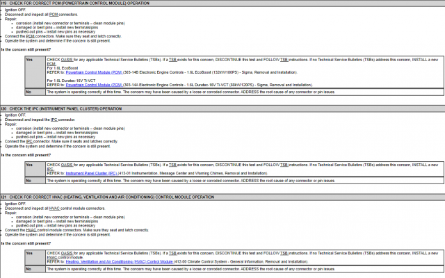

Before shooting the parts canon and wasting time/money, I'd diagnose a lot more. You don't even know if the command for AC is sent to the HVAC control module/IPC or the PCM. The fact that your compressor clutch is not kicking on should be a problem to be solved way before the fan not engaging.

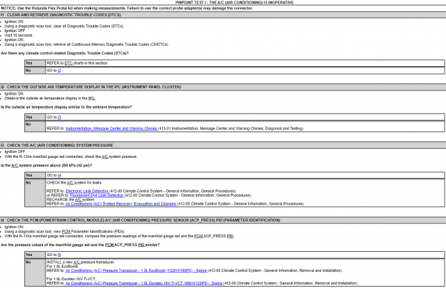

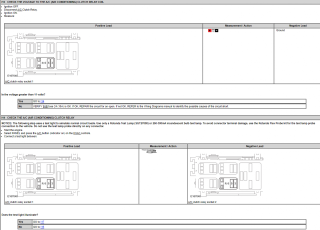

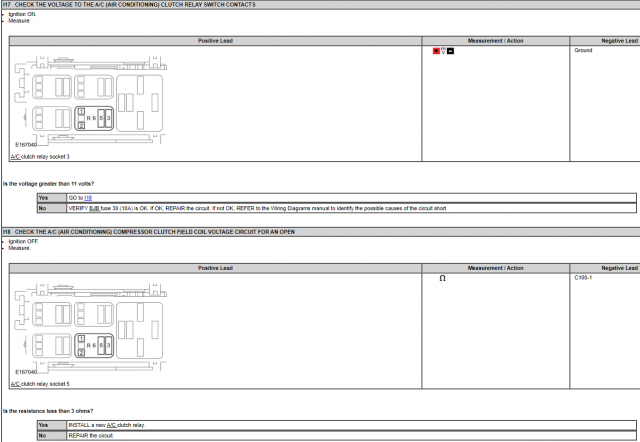

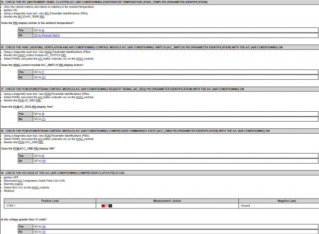

If you check my previous post, the requirements for the AC to kick in does not mention anything about the radiator fan. And I keep checking the diagnosing procedure and nothing there either:

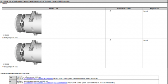

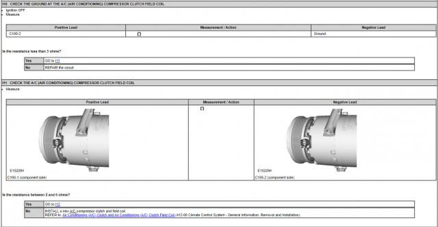

Definitely check the compressor "field coil"(clutch) as mentioned by the diagnostics. Super easy to check with a multimeter. You could also check the voltage supply on the harness side connector for the compressor. Have someone turn the A/C on while checking the voltage supply to the compressor.
