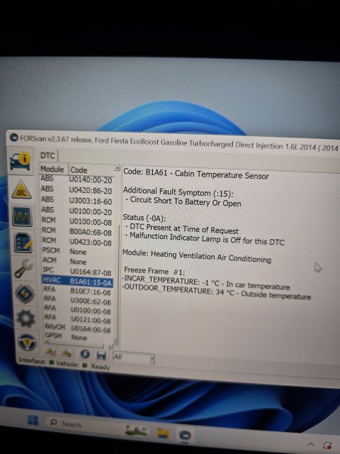

Scanned codes with FORScan and found in the HVAC module B1A61 Cabin Temperature sensor. Additional fault symptom circuit short to battery or open. Here is a YouTube video I recorded of the click sound it makes even when I have the actuators disconnected and the AC off.

The incar temp sensor is a part that's kind of in the way when you replace the actuator on the drivers side. Maybe you unplugged it? It's a cylindrical thing that sticks into a hole in the center console or left side of the dash.
https://www.tascaparts.com/oem-parts/ford-in-car-temp-sensor-3m5z19c734c?c=Zz1ib2R5JnM9Y2x1c3Rlci1hbmQtc3dpdGNoZXMmbD0zJm49U2VhcmNoIFJlc3VsdHMmYT1mb3JkJm89Zmllc3RhJnk9MjAxOCZ0PXN0JmU9MS02bC1sNC1nYXM=
I never touched it but Ill try reconnecting it and inspecting. I'm really hoping this is something simple the click is non stop every 5 seconds whether I'm using HVAC or not and having it stuck on recirculation sucks

Inspected the cabin air sensor. Nothing strange just a bit of dust I blew off with air and reconnected. I tried installing a new AC actuator and the issue is still persistent. When I start the car the AC door closes to recirculate and when I turn off the car it opens up so it's definitely working. Not sure why I can't get it to open and close on command and why it's making this clicking noise every 5 seconds....

Is this the part which makes that rapid fire clicking when it goes bad (or is about to go bad), sitting behind that circular vented bezel on the right side of the steering column??
Yes. But mine hasn't been making any noise at all. Even so I cannot find why I'm hearing this click click noise and since I do have a code for the air temp sensor I'm going to try replacing it.
