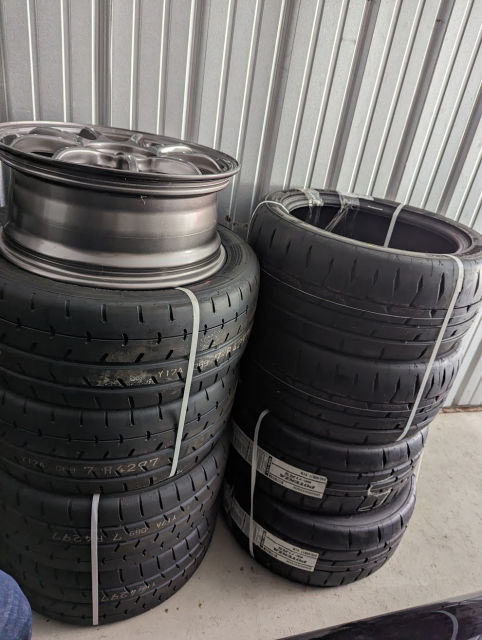

Heavy autocrosser here (~40 events a year including nationals).
I have personal experience on the ZIII (Have ran 2 sets on my Fiesta, one in 215/40/17 and one in 225/45/16) and personal experience on the new RE71RS (I've autocrossed a few Miatas on 225/45/17 and 245/40/17). Heavy autocrosses on both.
No experience on R1R.
ZIII is an older tire. Wears very well, if you were prioritizing daily driving and wanted to do an occasional autocross, it's not bad. If you get really serious into autocrossing, you're going to wish you hadn't bought it.
The RE71RS is lightyears ahead of the other two tires. It is currently the top dawg in the 200 treadwear autocross world, along with the Yokohoma A052. I found the RE71RS very easy to drive and communicates steering feel very nicely, whereas the Yoks A052 are a little more "edgy" in transitions....just takes a little more effort and steering input to get them to do what you want to. However, at the extreme limits of grip when pushing the car 10/10s, the RE71RS is a little less forgiving IMO. I could tell with Yoks are being overwhelmed a little more and were ready to break loose.
A052 are famous for giving a "hero" run when they are colder, and they overheat fairly quickly on camber challenged cars. It is not unusual to see national level folks cooling A052s off with towels dipped in ice bucket, covered on the tires, in between runs. RE71RS is a little more resistant to overheating. Both tires from what I have heard are fast to the cords - they dont tend to heat cycle out like the old RE71R.
If it were me, I'd only consider the RE71RS of the three you listed. I have a set ready to install for my STR Miata build. Love them.
