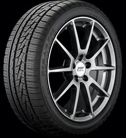

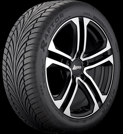

Ok, what I would go with is:
Sumitomo HTR A/S P02 (W-SPEED RATED) $67/ea. Probably a 50-55k mile tire
Riken RAPTOR ZR $63/ea. Probably a 30k mile tire

Those Riken's are made by Michelin. Not much on the interweb but there were a couple of post that said they were a pretty damn good tire?!?
