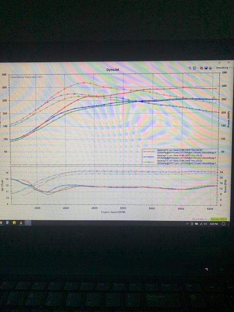

I have a Peron STG4 G25-550 setup, and all supporting mods. Uprated LPFP and 4 port stratified auxiliary fuel. Have the ability to run straight e85 but was having knock corrections due to excessive cylinder flooding so had to dial back to e50. I see positive boost around 3200RPM and peak boost at about 38-3900rpm. When I was running straight e85 pump gas (e75) I was seeing 19mpg avg and with 93 was seeing 26mpg - now running exclusively e50 I see around 21mpg avg. Granted I drive the car for smiles and not chasing mpg figures. I can’t completely speak to power figures yet because I’m still tuning it out… long process. I will say that without additional fueling the hybrids and s280 are a superior choice for many reasons. My final 93 numbers WITHOUT aux fuel were very mild… 275whp 300tq or so if I recall correctly. I would also strongly speak against using 4port injection. It doesn’t do the best job and is hard to tune precisely. If I was to do it all over I wouldn’t change anything but the fueling. Certainly go with the HPFP upgrade and uprated injectors.
Here are 3 overlayed pulls on the same revision working out auxiliary fuel now… just for you to observe the curve etc. Still mild boost and timing until corrections resolved.
