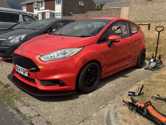

First up was to install wire tow loops - the MSUK rule book says that 1 front and 1 rear is required, but 2 at each end is preferred. I wanted to preserve the fixed front tow hook so I have them coming out of the grille. I used an M10 12.9 bolt with a thick washer on top and bolted them into the crash bars with nylock nuts. While I had the bumper off, I also installed the MGC splitter brackets. Still need to pick up some plywood to make the splitter.

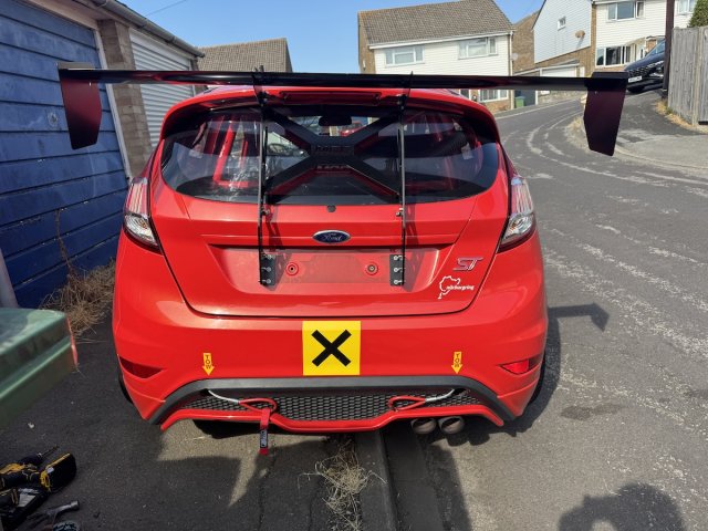

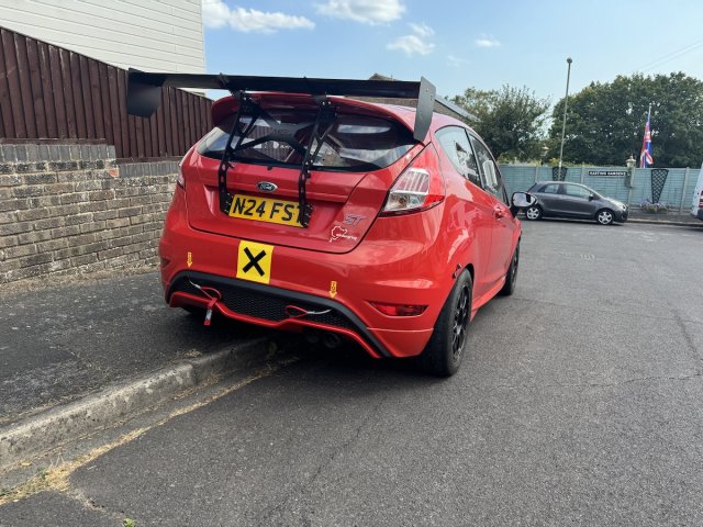

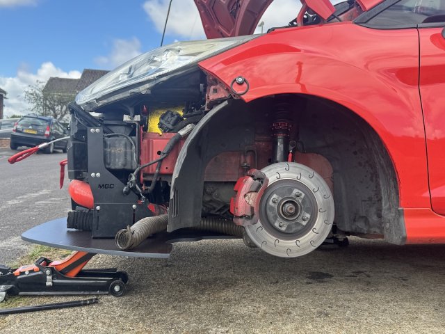

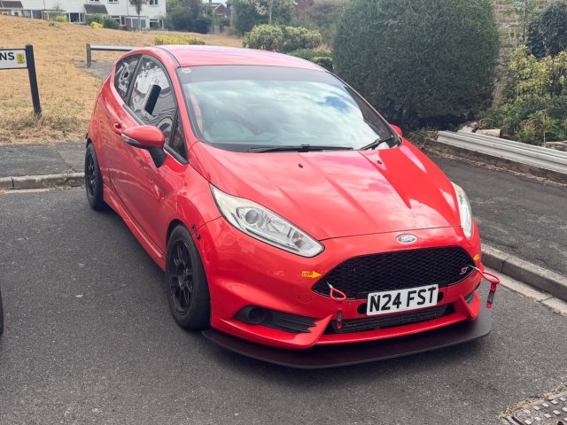

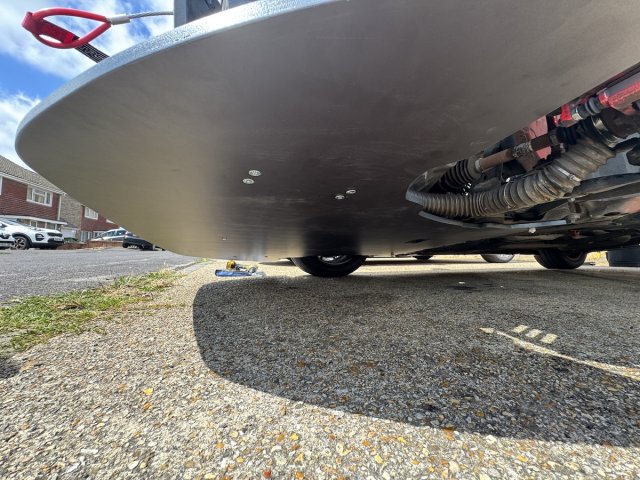

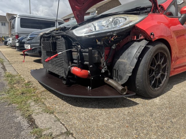

More Time Attack prep for next year - Aero! Fitted an MGC Modifications rear mounted wing and chassis mounted splitter. Had a friend cut out the splitter for me out of 12mm phenolic plywood and seal the cuts. A few weeks ago I fitted quick release bumper/fender catches which have already paid for themselves! Took 10 seconds to remove the bumper instead of fighting to get the 3 wing bolts out. No issues fitting either, and despite the wing not being chassis mounted it feels rock solid. It is just narrower than the width of the car, although I still think TF at the ring will be off the cards now.
Haven't fitted the air dam yet as I'm not sure if I want to go down that route or use some adhesive foam instead - not really a fan of how the air dams look even though it would be very effective. Booked Castle Combe for the 25th September so will get a chance to test it all out.
Still need to fit the plumbed in fire extinguisher, external cut off switch and hood pins, but that can all be done over the winter.
