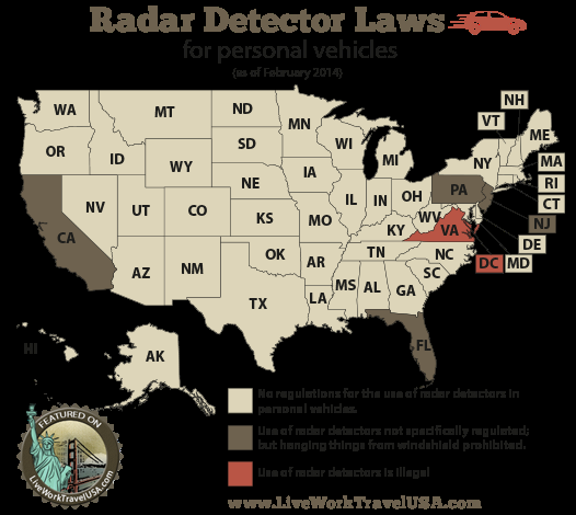

#40
The only place they aren't legal IS D.C. and Virginia....a few states don't like them being stuck to the Windshield either....Thats why you get a Rear view mirror mount......its sneaky and stealthy! This map shows even though its 2014...its still relevant.
