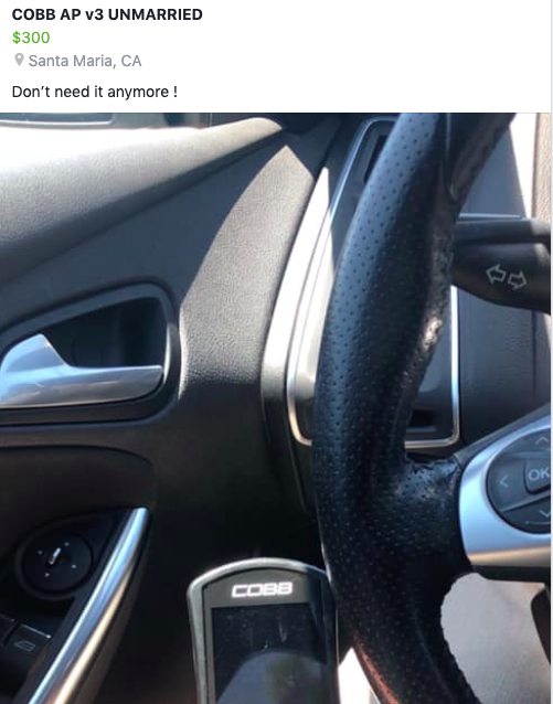

There's been a few in the $400 range posted in the past few weeks even here. They're resold often enough that with some patience and luck(they can go quickly sometiemes) you'll find one in no time.
Another suggestion as well if you purchase new there is the deal from stratified where you get a free flash tune with the AP if you buy from them.

Ok well that's a place to start. If i can get an AP in a timely manner and if a canned tune is a few bucks more than i have left over i can always get a OTS to start and a couple weeks later i'll be able to throw another hundred at it for the canned tune. So now the trick is to find an AP for $450 or less, and hopefully not 6mo from now.
Keep on close eye on the for sale thread. A few days ago, someone posted their AP and a pillar mount for $400. 10 minutes later it was mine for $390. All of those things new would have been about $650. Plus it came with a stratified tune.
