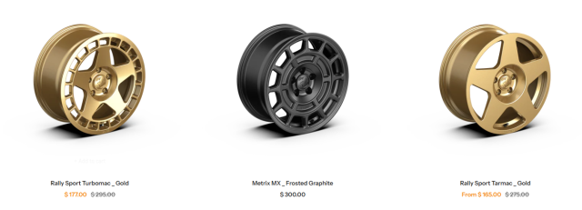

I've always loved the Hoonigan/Ken Block style Fifteen52 wheels on the Fiesta, ever since watching Gymkhana videos. But even in 17" sizes, they weigh WAY too much!
My 2015 came already on some lightweight Enkei 16's (if anyone knows the exact model, LMK!):
As much as I am sure these are great for weight savings, they look quite small on the car, especially at stock ride height. So, I started looking around for 4x108 options, but they are quite limited. Fifteen52 DOES make some options for us, but they are also like 25+ lbs per corner(!!). Does anyone know of a similar style to the Tarmac or Turbomac style that is available in our BP and size that will fit, without being way heavier than stock?
Thanks for any help or suggestions, and sorry if this has been covered already! I promise I searched around, and found some really good suggestions, but most of those (like the Motegi MR125s) are no longer in production from a few years ago.

You have Enkei J10s. 16x7 +42… not exactly light compared to RPF1s…
https://enkei.com/shop/wheels/performance/j10/
Also, those 1552 are cast, so despite being heavy enough to anchor a yacht in rough seas, the wheels will bend/crack just as easy as OEM wheels, which is well known.
Konig makes 17s that don’t suck using the same technology as Enkei. Rota makes 17s that look similar to the junk from 1552 & about the same quality.
You could also look for Chinese 80/90s Mustang wheels, they have 4x108 BP, but the offsets will usually poke outside of the Fiesta fenders about 1/2”.
Tirerack has the best FiST appropriate wheel selection available, unless you have coin to order custom wheels.

Oh, yeah, totally agree that Fifteen52 is for looks ONLY and not performance or quality. Just sucks, since I dig the look. I saw some Rota's that were similar design to the Turbomacs, but I also am not a fan of cast wheels so that kinda sucks. I guess I could always go for some Konig's and just abandon the design I was after, but I had a hard time finding anything in gold by Konig that fits. Powdercoat is always an option, but this is supposed to be a cheap daily, so I didn't want to end up having more $$ tied up in some 17s than I have on my main car!
