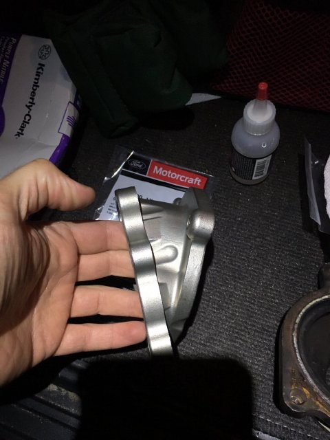

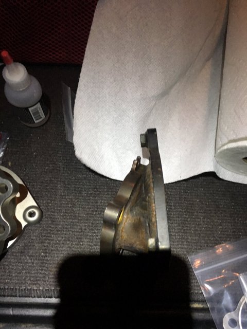

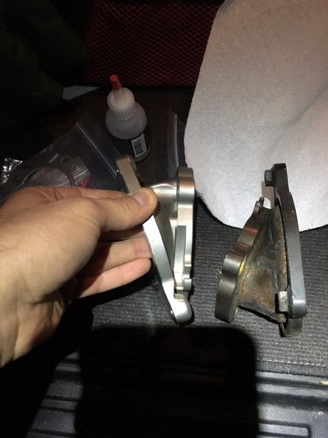

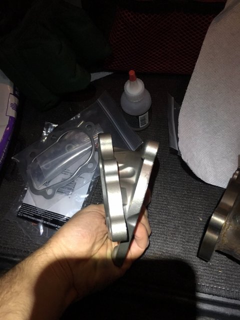

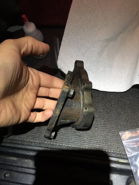

I bought some of that too @TyphoonFiST (in the background of these photos). Check out the quality difference between the Mountune downpipe adapter (cast & machined) versus the ATP (ugly welded piece of snot). There should be more clearance with the Mountune unit to tighten the bolts and I also got the Stage 8 locking hardware.

I agree. I bought it because I thought it more give more room to tighten the bolts properly. It doesn’t. It’s much better built and I can trust it to have a nice flat mating surface.
Despite all of this, and tightening the downpipe adapter both on and off the car with a variety of different hardware, I can’t get it to pressure test without leaks.
I am sending it back to ATP for a warranty inquiry. I figure they either replace the turbo because of a bad mating surface on the turbine outlet, or they get it to seal properly. This gives me some piece of mind if I decide to sell the turbo with low miles or put it back on the car.
