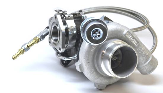

That thing is a work of art. The fact that they offer two sizes is icing. Well worth it in my opinion.

If I can try to sum my understanding, so I can make a cliffnotes version of this for my own reference (I desperately want a turbo upgrade XD), I feel like I'm reading that the 300-350 hp turbos by ATP are, realistically, the ones that are truly "bolt-on", in that you don't have to do anything else to the actual mechanics of the vehicle (pump, etc.).
I know it's wise to upgrade the IC, piping, etc. But, and correct me if I'm wrong (please), but I'm looking at the 2554 because (a) 300 hp is fine with me, I just want a turbo upgrade, and more importantly (b), as the smallest, it's the closest to the factory's spec, so the least-likely to put excess strain on the rods, shafts, and linkages. Does this sound accurate?

You need to research more before even considering a turbo upgrade. Bolt on means just that. It bolts on to your mani and DP. You will need a IC, Exhaust and DP to get max power. Smallest turbo has nothing to do with strain. Notice how the Tq curve changes but the number doesnt. TQ breaks rods not HP.

Yes, the ATP turbos are "bolt-on" upgrades. This means that it will bolt up to the existing manifold and downpipe. No one really knows the stress point of our internals, so let us know :) I would recommend upgrading the IC only because tests have shown the stock IC has a hard time keeping up with Stage 3 setups on the OEM turbo. Also, you will need a tune for the new turbo, so make sure you get that as well.
