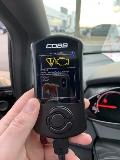

update/ help.. Dealership called yesterday and told me the work was done on the car, but i needed to come reinstall my tune. He explained that everything worked fine after replacing the timing belt and VVT solenoids, and then they reset the KAM and it started not being right not wanting to start and idling rough. I go over install the tune I've been running for about a year, then try to start it and it still doesnt want to start, and when it finally did the idle was rough and tried dying a couple times and if you give it a rev, the RPMs hang for 5-10 seconds before dropping back to almost dying.. I checked the knock count global and on each cylinder individually and nothing showed up, and no check engine lights or other weird indicators of something wrong besides the OAR being at -0.65 when it was at -1.0 when I dropped it off.
I don't have any idea what is causing this, the service tech doesn't know what's going on and they're going to get it in the shop today to do more checks on stuff and try to figure it out. Does anyone know what could be causing these issues??
*I'm also a little worried when he asked if its a tolerance engine, which I've seen talked about on the forum quite a bit. Not gonna lie, feel like I bought a dud version of the little ST... I've owned it for 20k miles and been in the shop for a ton of issues that you wouldn't expect out of a car with 32k miles (when bought), really makes me consider sucking up the loss and getting something else
The oar resets when you change tunes. If after driving for a while it didn’t go to -1.00 then you would have a problem.

Thread Starter #18
Thats a good point, which is probably why that showed up. I'm just lost for what could still be wrong with the car after they "fixed" all the issues caused by the belt breaking.
I feel like I got a dud because it has had all the issues people talk about on here plus more and its been in the shop a ton since I bought it unrelated to the mods I've done. Keep thinkin about a civic SI since they are more reliable lol
