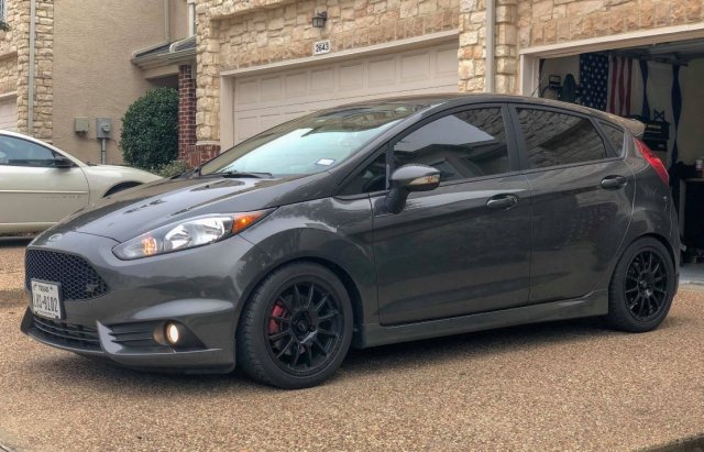

@Mikey456 If there is a rake I haven't seen it on an example yet. If I recall this was whiteline on stock struts/shocks. I typically run 205/50/16, recently changed to 205/45/16 for my travel set and my around town are 215/40/17. I am going to try on both my 215/40/17s and 205/45/16s, although more interested in the 215/40/17s. Just to note I really miss my 205/50/16s...lol. I run 36lb nitrogen across the board. The only poly bushings will be for the front sway bar.
I am anxious to see if the below is the case

A member named Koozy had the whiteline springs on his car. I don’t know if he is active anymore. The rake is slight but I think the amount of drop is probably on their website. I think Koozy also mentioned that he was rubbing with the 215/40 setup but I think he had 8 inch wheels. I think he has his build somewhere on the forum.

My 17s are on 7.5in wide so we shall see. I am anxious to find out all of the different variables and driveability for each setup. I was already aware of the drop of the whiteline springs which is advertised to be 30mm =1.2in front/rear. I won't go below 1.25 for my testing

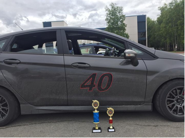

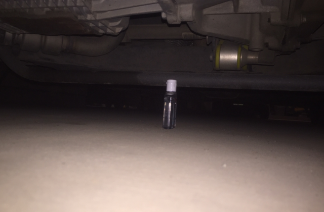

I had the B6/Swift setup and liked it a lot. I moved to the Fortune Auto 500s because I wanted to be able to do some fine tuning, but probably would have been happy if I stayed with them.
If you run a Pierce lower brace, be aware that clearance will be lower.
