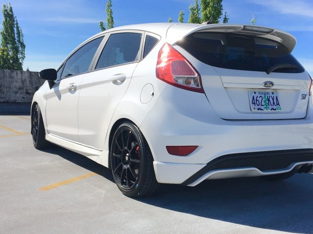

I have the B14 PSS adjusted to halfway on the height and am very happy with the setup. The ride is firm but more controlled than stock. With OEM wheel/tire size I have no rubbing at all, even over the biggest whoop-dee-doos.
