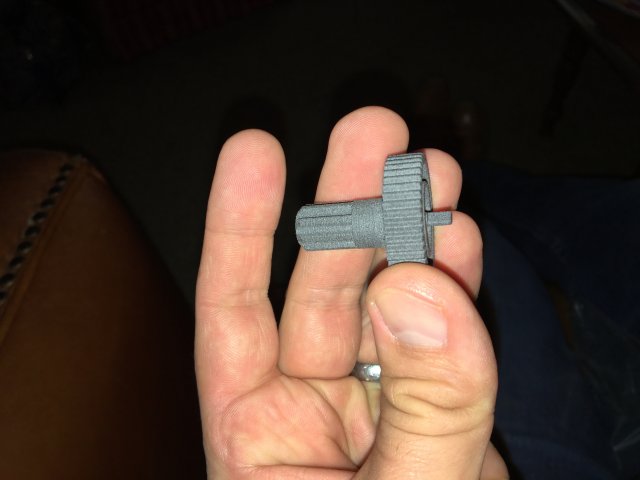

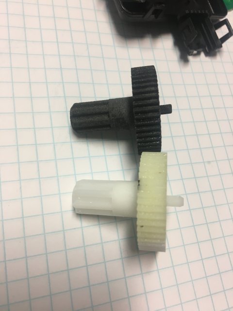

I measured and modeled the existing gear that typically breaks with the hope that i could make a part that was robust enough to outlast the factory piece and limit the amount of time you have to swap out the assemblies. This prototype 3D printed part is made from carbon fiber reinforced nylon 12 and printed using SLS. I will install this in my fiesta ST and provide some feedback as to if it solves the issues we have all experienced with those blend door actuators failing.

Love this conceptually. It's so interesting that everyones last for different lengths of time, which makes me feel like you'd really need to test...20-30 of these and get feedback on the longevity for each.

I just took four of them apart to see which teeth are broken. They are all in about the same location on the output gear. That seems to match up with your idea about the position sensor not providing the correct position. Two of the gears that I looked at were from the passenger side, so their failure can't be blamed on a bad position sensor. I suspect the actuator just moves the fresh air door until its fully open or fully closed. but without a feedback sensor, the controller has to guess the position (time, load, who knows?). I rarely cycle this door (as you speculated), so maybe the computer tries to move it to the commanded position each time the car is started since it probably doesn't know where the door is (on startup). Still, the gear is too weak. The gear should be able to sustain the maximum torque that the motor can generate.
