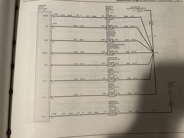

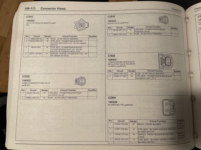

You’ll have to hunt down the actual connector unfortunately. The part number referenced is only the complete engine harness
Here’s the Motorcraft pigtail catalog where you might be able to find it
https://www.motorcraft.com/content/.../wire_sets_wiring/18376-Pigtail-Book-2016.pdf
Images of wiring guide attached
A lot of the connectors in the Fiesta are manufactured by TE - I’ve had a little luck using Google image search to identify a couple of them, but it’s a bit of a needle in a haystack.
AA7D1EC0-C672-48A7-BE17-24FA000EB67A.jpeg D0E6124B-A9AC-4915-8E36-B53B5AC5699F.jpeg
