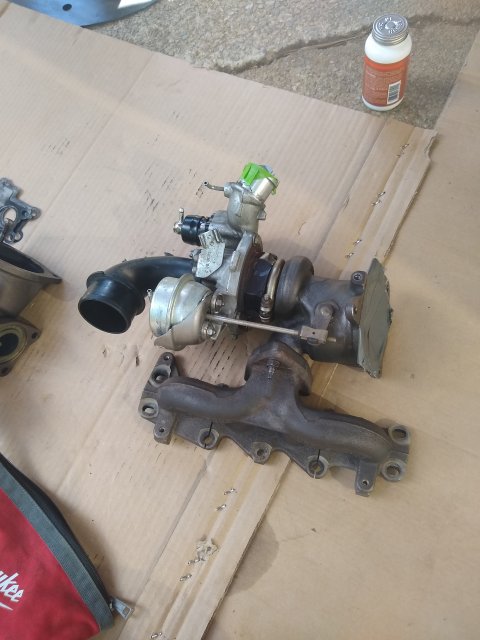

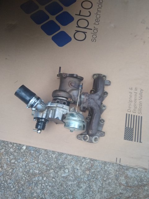

Finally had the time to start removing the old turbo. It appears that the previous owner did something with the turbo and then reinstalled the stock turbo. Also I don't have a turbo heat shield or downpipe heat shield . . . PO must have kept them.
#21555
325
505
Man that whole assembly is tiny hahaa! Congrats on finally getting it out! Looking forward to hopefully seeing you back out there soon. ;)
Yeah, my brother and dad thought that the exhaust manifold was hilariously small!
Hopefully everything will go smoothly and I'll be back on the road by Monday.

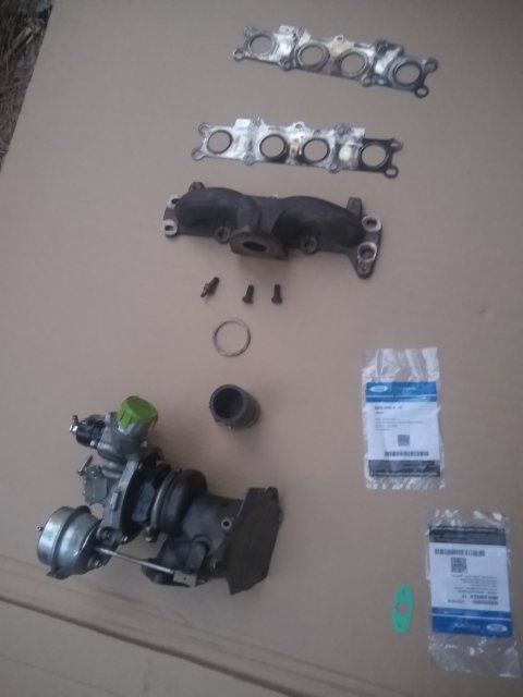

Is it normal to have two gaskets between the exhaust manifold and block? When I pulled it there were two.
Also is there a gasket between the downpipe and turbo?

Thread Starter #13
Yes, there is a gasket between the downpipe and turbo, mine was just stuck on the downpipe.
Turbo assembly ready to go back in . . .

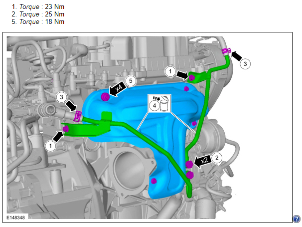

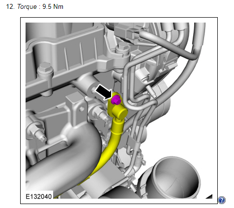

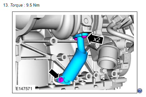

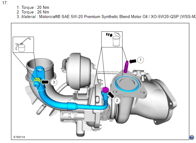

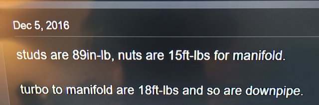

Does anyone know the torque specs for the exhaust manifold, downpipe to turbo studs, and the oil and coolant lines to the turbo?

Thread Starter #17
How tight would y'all recommend going on the banjo bolts for oil and coolant?
Not very tight, kinda tight, really tight?
