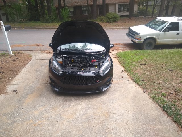

Well, the good news is that the turbo is in and seems to be working, also I got to drive my fiesta again! The bad news is that my car is still randomly stalling at idle and it's still only making 5 lbs of boost max. I can hear the bov working like it should, but it just isn't making boost.
Could it be the boost solenoid? I'm kinda stumped at this point. I cleared the kam and the codes so I guess I'll just drive it until I get some more codes.

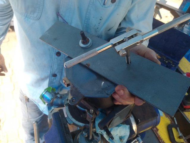

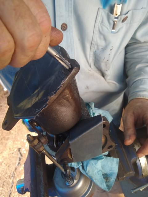

I'm going to add how I (and my dad) cleaned up and rethreaded the turbo I got from @jessemon1106. It appears that he had to drill out the downpipe stud, so the threads weren't usable. We cleaned out the hole with a file first then my dad made a jig to keep the drill bit lined up. I used a tap kit from lowes ( the downpipe stud is a M8x1.25 if anyone is wondering). After we drilled the hole we slowly and carefully ran the tap though the hole several times. Some of the old stud was left in the hole, which complicated the tapping process. My dad removed it with needle nose pliers. Also, when drilling though the metal, we used quite a bit of motor oil to keep the drill bit and hole cooler.
There's probably a better way to do this, but it worked fine for me so I figured I'd throw it out there to give y'all some ideas.
