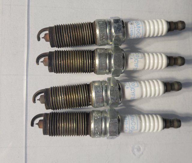

They look consistent - the NGK's with a tight gap (I think I was down to 0.025?) will allow your tuner to improve the power delivery - should add some HP with a cleaner / quicker ignition.

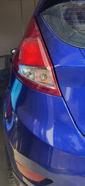

Changed the rear turned signals out for Silverstars. Quick and easy and takes away most of the orange.

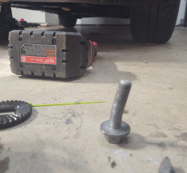

Some updates for tonight. Swapped out the Cobb RMM with a Whoosh Race Spec. Installed the Summit/Swave rear 2 poi t torsion bar. Replaced the pass side motor mount with a Vibra Fast Road. I suspect I'll have a net increase it NVH but I suspect this pass side bolt was not doing me any favors! Another revision of my tune due any day now as well. Oh and more goodies came in.

That bolt was for the Top of the passengerside engine mount? If so....man were you living on borrowed time!

Yup it was. In my investigation/repairs of this car, it was in an accident and fixed BEFORE the one that sent it to the salvage yard. Who knows if the previous owner was driving it around like this. So it's lived a rough life for sure but it's coming back stronger than ever. Also big shout-out to my Milwaukee M18 impact wrench because it took a beating getting that bolt out.
