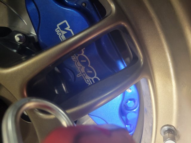

Pulled apart the rear suspension to do coilovers but realized I didn't have the upgraded spring mounts. Ordered them from Whoosh. Also installed Dpro camber arms while I was in there. Lastly I test fitted my wheels without spacers and all and they seem like they fit over the brake kit! I posted more pictures in the brake/suspension subforum.

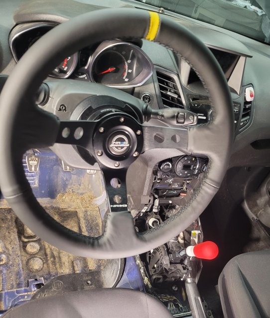

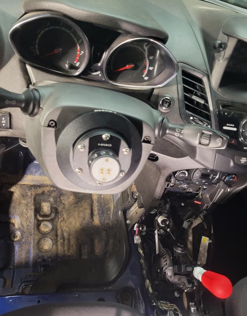

Finished Dpro rear camber plates and rear ISC coilovers with Powerflex spring mounts.
But I also did an NRG hub, quick disconnect, and steering wheel. I don't need inspection until the Spring so I'll figure out the horn during the winter but oh boy do I love the look and feel of this setup. Excuse the dirty floor.

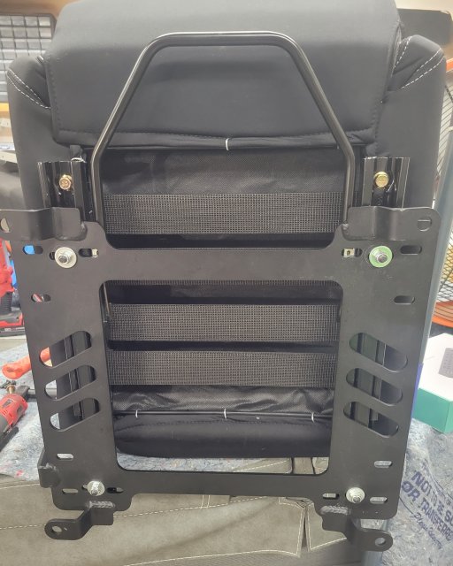

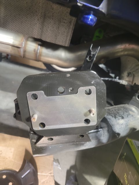

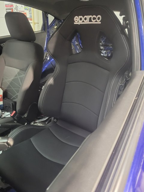

Sparco Chrono seat went in along with Sparco sliders and Planted bracket. Ez pz. What do you all do about air bag lights? Just ignore em or can I disable something in ForScan? Currently the seat belt buckle plug is disconnected and the driver's seat airbags and steering wheel airbag are both removed. Haven't started it up yet, turbo getting swapped this week!

#4150
14,718
7,194
Yup - I'm actually the last person that posted there! A little more complicated when the steering wheel is swapped too. I think I'll just deal with the light. Not a requirement for inspection where I live.
Will insurance give you any grief over the lack of any exploding whoopee cushions?
Woods247
#5473
2,682
4,891
I inserted the fused resistor from NRG in my steering wheel airbag connector. Works fine. I just shoved a resistor (2ohm I think) like the one in the post above inside my seat connector. No light.

Thread Starter #139
Which one for the wheel? And what about the wire/plug on the seat belt, does that not cause issues?
