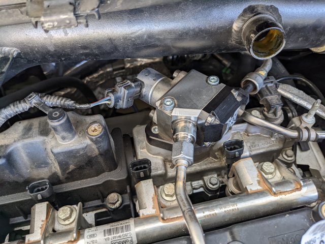

Man, it really is a shame that a $1400 fuel pump, with a wait time, is the only upgrade option we have. At least we have an option, though.
Don't forget you have to modify your coil holder thing to use it too. PXL_20220828_165625221.jpg

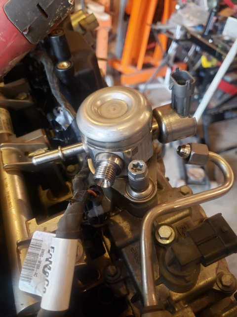

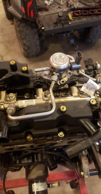

Not to highjack the thread but A budget friendly upgraded hpfp was something I attempted about 2 years ago or so. Focus st hpfp. Required a custom lowside fuel line and a adapter plate to mount using the stock high pressure line. It Worked and the car ran great after some adjustments but end gains where minimal. Ended up not being worth the headache. Port injection is Bae ❤️
F0DA11FF-54E4-4770-84D0-CC976D159AE3.jpeg 933C8038-E2F5-4F38-973C-C1B1DCF93BFA.jpeg
#10524
308
355
What did you do that helped it work? As far as it supplying the necessary fuel rail pressure?
The Jag HPFP fits in the Fiesta ST OEM location no problem and bolts in exactly like OEM. The only difference is the fuel lines are oriented different.
I don't know what the xdi HPFP secret is but technically the Jaguar HPFP will support up to 200 bar.
I did notice that under 4k rpm it will flow more than desired. Desired 2600 psi actual 2900 psi. Above 5k rpm desired is 2700 psi actual will dip under 2000 psi.

#8474
66
199
So 200bar is only 2900 psi 😅 thats my target psi with the stock hpfp it will hold 2900psi fine if your supplying port injection and not running the hpfp to its limits. As far as the focus st pump i have the data for it so i used it with some tweeks. The issue is more the cam lobe then anything so if you look at a focus rs and st the hpfp is the same and same pn and can be swapped the difference is the rs is a 4 lobe cam and the st is 3 lobe. On the rs it supplys alot more fuel due to this but you also have to look at lift, duration, lobe count ext. Witch all effect what the pump is capable of. So because the jag pump is bolt on doesnt mean the cam lobes are the same between the fist and jag and will supply the same volume of fuel. Same with the fost pump i assumed id be able to push to the mid 300s on the fost pump like i can with a focus st but i found out it just wasnt going to happen on the 1.6 now maybe if i chop off a focus st fuel lobe off the exhaust cam and weld it to a fiesta cam it might work better but its kinda just not worth it. Pumaspeeds exhaust cam might help a bit with the stock hpfp and even more with the jag hpfp or focus st hpfp but someone has to try it 😅 id be willing to test if these companies would work with me on it but thats like pulling teeth! but for now port injection is still imo the best option
