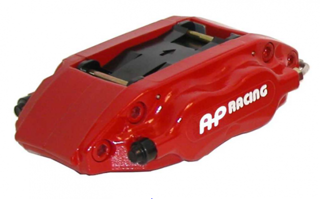

It takes D46, Ap Racing 7600 caliper. I looked into it, seems Gloc, carbotech,hawk, and most manufacturers all have options for it.
My biggest worry is that if I try to daily any of those really aggressive pads, that it's just going to chew thru rotors and pads like no-tomorrow :(
Link to the caliper:
https://apracing.com/performance-up...y-130mm-mounting-centres-suits-o295x24mm-disc

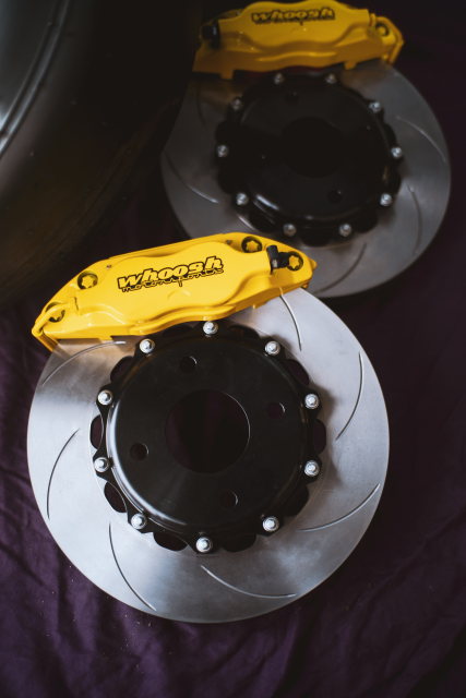

Oh wow Whoosh is using AP Racing calipers? It comes with 2 piece rotors too? if so, what a steal for $1k

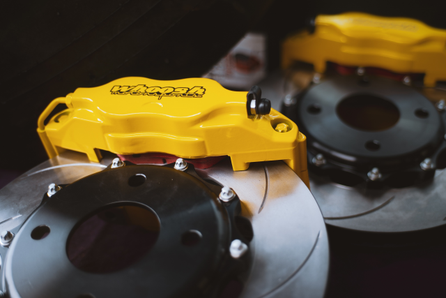

Any small ap type markings/castings on them at all, anywhere??
I didn't see any on mine, but not 100% sure. The only difference I can see in the pictures is the bolts that hold it together. The piece that holds the pads down that has the arrow looks the same on mine as well.
Maybe they're different, but they use the same pad size as well, so I'd imagine it's either the same AP caliper or something else that looks damn close.
251
156
Los Angeles
#36
Caliper "AP7600-like", down to the four pistons.
Running Orangestuff all around on 300mm Whoosh BBK and rear EBC USR rotors. Nice balance for fast canyon, no unusual wear issues (no melting issue). No cooling ducts/deflectors. Can fade brakes with back-to-back triple digit hard braking (on Mexican streets...), but cools much quicker than prior stock front caliper/Orangestuff/EBC USR setup.
Additional bonus: less unsprung weight AND lower (by a tiny bit) rotational moment-of-inertia.
