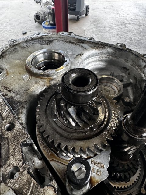

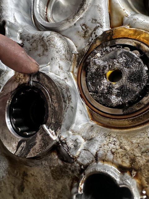

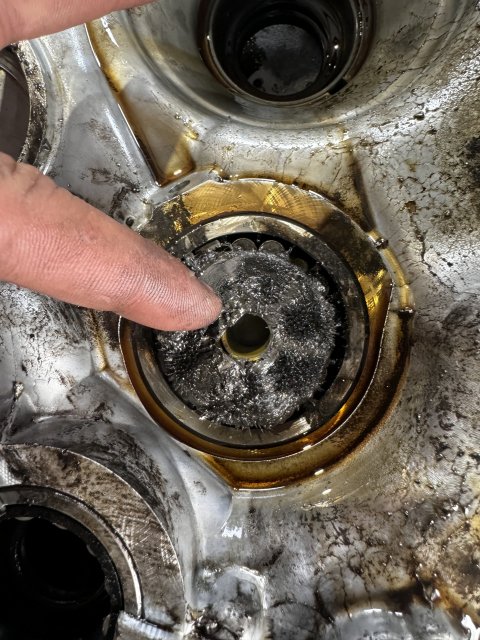

Hey guys I’ve recently had my transmission go out on my 2016 FIST. The shop sent back pics stating I’ll need a new transmission and it’s not rebuildable (pics attached). They said a used one from LKQ will run about $1700 and a $1000 for labor. Does that sound reasonable? Also are there any other good options on finding a used transmission for our car or a shop that rebuilds these types of transmissions? Thanks for any advice.

The price is average. But I'm trying to recall another member saying something about a bulletproof transmission overhaul company..

Clarke is who I used and would do it again. He’s not cheap though but peace of mind is nice. Just be sure to return your core. Colby is very honest.
Regarding $1000 labor, that’s about right. It takes a long time to drop and swap the transmission in this car. Don’t forget to install a new slave cylinder, clutch (and flywheel if needed) while you’re in there. It’s also a good time to drop in a LSD if you don’t already have one. Colby sells transmissions with them installed and ready to go. Wavetrac > MFactory if you’re tracking the car at all. MFactory is fine for daily rips.
