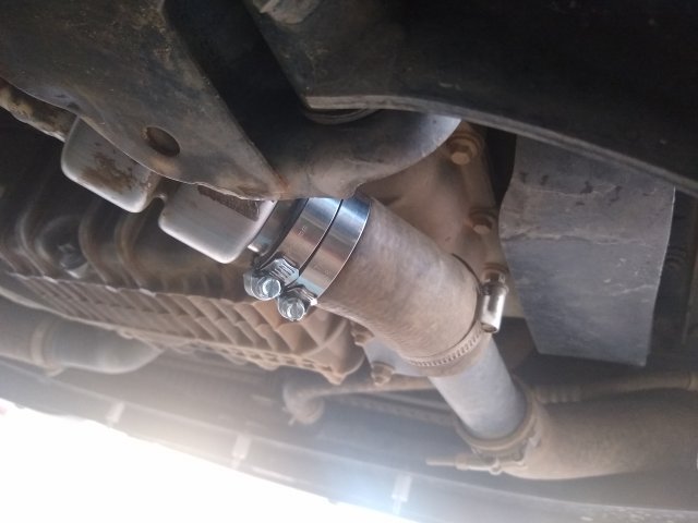

Double up the hose clamps and get some hairspray that will act like a lube but then an adhesive when it dries. Told you.....it was the hotside pipe/hose.

Thread Starter #14
First attempt to fix it using the stock parts failed. I went to O'Reilly's and now it's double clamped. Looks like I'll be hairspraying it tomorrow IMG_20220408_183544784.jpg
