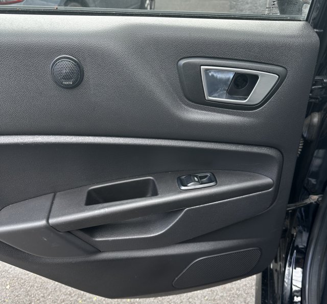

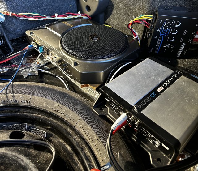

The speaker installs were straight forward. Precleaned the door surfaces with isopropyl 91% alcohol before tacking on a couple of sheets of Kilmat behind each speaker. Crutchfield includes the adapter rings which fit perfect. I used the included adapter harnesses for connecting to the factory speaker wiring on the rear doors only.
I first wired up a 2-channel Audio Control LC2i but quickly realized it wasn't enough. I wanted to fade the inputs so I returned it for the 6-channel LC7i. Each door has 2 wires going away from it and 2 going back to it. That's eight 14 AWG wires running down each side of the car. The 1st run was to extend the factory speaker wire to the line level input on the LC7i. The 2nd run was from the amp to the speakers themselves. If you don't have a fish tape, GET ONE.

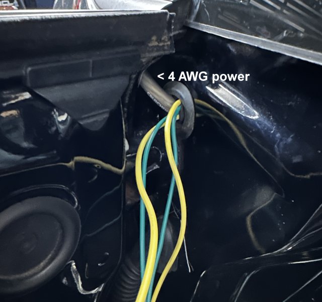

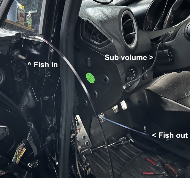

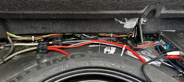

After many cuts and curses, wires fished! Notice the power wire isn't red. Crutchfield didn't have red in stock and everything on Amazon was copper plated crap. I did use a small scrap of red at the battery/fuse holder just to denote that this random black wire is indeed power lol

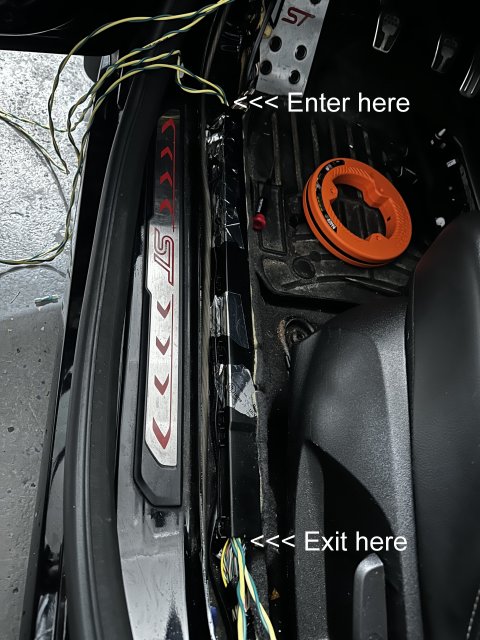

My recommendation is to use the existing wire channels Ford provided in the front. Another quick tip is to remove the rubber seal FIRST, then pull the interior plastics.

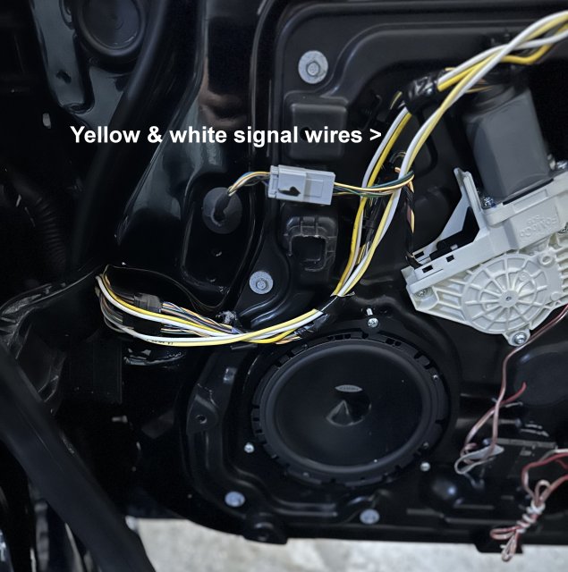

I tapped the front signal at door harnesses requiring wires into the door panel. I learned the hard way after disconnecting the factory accordion gromet that it is impossible to put back in. I did run my wires through it with the fish tape but not worth it in the end. On the driver front I left it alone. I wrapped my wires in black tape and tucked them behind the accordion instead.

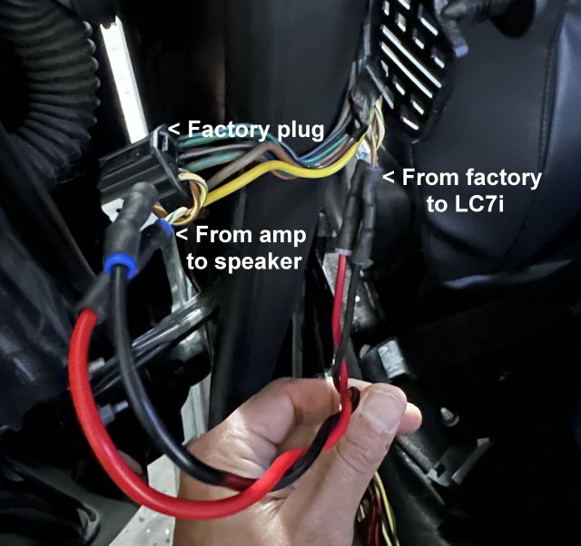

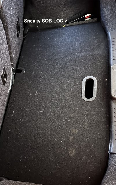

For the rear, I spliced the factory harness clipped in at the B-pillar, reusing the factory wires/adapter harness to the speakers - probably my favorite part of the install since it was so easy and neat.

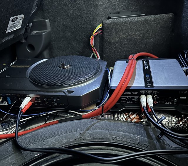

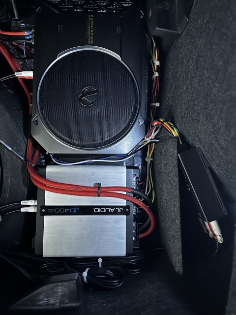

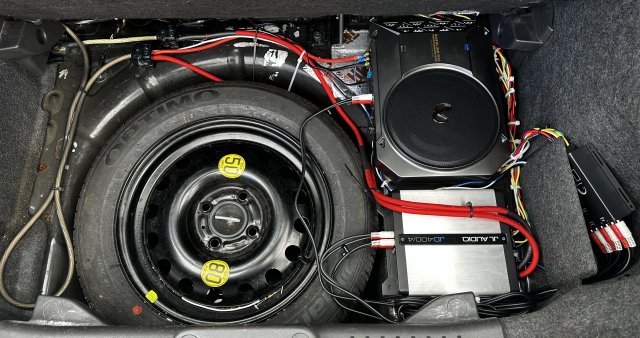

In the hatch, I tacked down some Kilmat directly under my planned install location. The floor is filled with dips and bumps everywhere. To level it, I used sticky velcro pads to secure 1/4" MDF that I wrapped in Gorilla tape. Wrapping it in tape provided a smooth, clean surface for more sitcky velcro pads to secure the amp and sub. I had a couple of screws just long enough to secure the sub to the MDF w/o getting into the sheet metal. I also cut away a part of the side pocket so that the amp would fit.

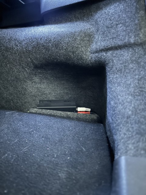

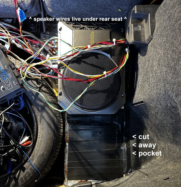

The amp just barely fit while leaving enough room for the LC7i to tuck away into the pocket. I also cut a piece of the side pocket "door" thing to allow for the power, ground, and remote wires to sneak into the LC7i without stress.
The finished product

  • The ground wire on the amp is red. My first order from Crutchfield included a red 4 AWG power wire. But measuring off the top of my head, I ordered it too short. My install started and ended in 60 seconds lol. I went to order a longer red one but no stock. I ordered the black and got going. I shrink wrapped a few bits of black plastic on the red ground and so be it.

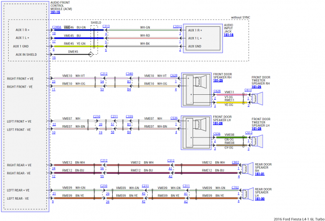

  • I didn't include the tweeter signal from the front factory harness. I don't really understand how I would have included it on the LC7i with all the input channels filled. I don't even understand how it could be included at all. I plan on a JL Audio FIX 86 in the distant future but even that device would run out of inputs. This is where I regret not pulling the signal direct from the head unit. Are the head unit and amp separate? If so, this would allow us to grab signal before the crossover splits it. Can anyone confirm this?
  • The LC7i AccuBass is no match for the muck coming out of that factory head unit. It's better than nothing but the bass still drops off at higher volumes. I feel it starts to happen around 19. And once in the 20s it just wreaks havoc. I'm going to re-adjust my levels so that 20 is the max and see if I can crank it up without the factory EQ interfering. I'll report back.
  • I didn't use a remote turn on lead. The LC7i can turn on from speaker level signal. Seemed like a great time saver and it works well, but it causes the sub to make a low pop when the system shuts down. I tried moving the ground and reducing levels but that didn't help. The googles had some complicated relay/capacitor solution that seems like overkill. It's especially annoying because our cars send a speaker wire signal when opening any door or even the hatch. So i find myself rushing to turn the car on so that it won't pop lol I have yet to win this game. I may run a dedicated remote sometime in the future.
I'm an audiophile of sorts. I'm used to replacing a head unit and feeding amps from 5v preamp outputs. This is my first LOC install and I have to admit I'm not fully satisfied. I can hear the signal drops in some songs and inconsistent bass sometimes. It's mostly over volume 19 that this happens tho. And yes, I used FORscan to shut off the processing and it got better but like stability control, it's not fully defeated dammit! It sounds REALLY good when parked too lol. But once I'm driving, the Ford EQ takes over and bleh - saving up for a FIX 86/TWK-88.
I want to also mention that this system is not shaking windows or rattling dentures. It can barely be heard outside the car at full tilt. It's not loud enough to drown out highway noise with the windows open either. But it's a got a certain quality and thump that the factory stuff just didn't have. In the end, the system is a night and day improvement over stock but not the best it could be. I'm mildly content....for now.

According to this diagram from AllDataDIY, it might be a full (albeit Ford EQ'd) signal at the head unit (ACM) for the front door speakers. There's no indication of a crossover situation until it reaches the door itself. At least that's what this looks like to me.
