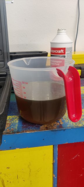

Actually had my first go around with this last week and was dreading having to pull my damn trans out for this sht. It's not a difficult job, just annoying lol. Started happening on a very hot and humid day when I have the a/c on.
Would only happen if I had the clutch pressed down for a good amount of time. I always knew when it wasn't going to fully come up because the bite point of the clutch got VERY low and eventually when I fully let off the clutch it wasn't coming fully up. Was intermittent though and not every single time.
Went with the most easy solution to try first and bled my brakes and slave with a mityvac. Probably should've done this a long time ago, only time I bled my brakes was when I put the BBK on. Never bled them after the numerous track days I did lmao.
Fluid came out dirty, couldn't necessarily tell if there was air in the system because my clear vinyl tubing from my mityvac was slightly too big on the bleeder nipple so it pulled air into the clear tubing from the atmosphere while I was pumping the mityvac. So there were many small bubbles from that but was still tight enough to not leak fluid out while pumping.
So far it been flawless. Its been much cooler outside though so idk if temp affected it or not. But after doing that its been fine. If that didn't fix it I was going to replace my master cylinder first since people have had that fix it too with my symptoms, plus I don't have fluid leaking onto the ground from the slave.
Time will tell. Maybe I'm too hard on myself but situations like this I'm not satisfied immediately until I put it through its paces.
Here was my fluid:
