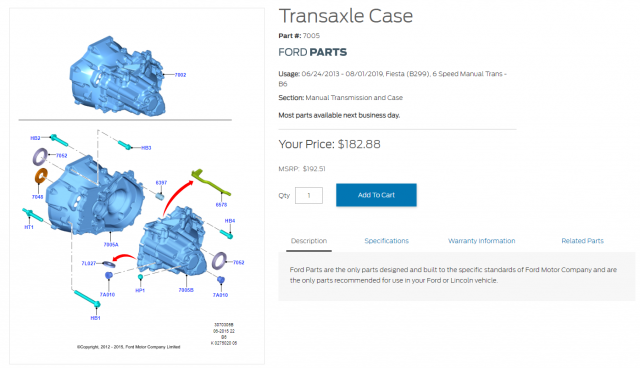

Hi all,
Unfortunately, it appears a combination of my sticky tires, an over-torqued bolt with no anti-seize, and the poor design of my RMM caused the threaded extrusion on the transmission to crack. I was able to find what appears to be the replacement housing on the ford site, but the Part number seems extremely generic. Does anyone know the full part numbers for our transmission or can look up the full part numbers? C1BZ-7005-A says it fits the 6 speed manual in a fiesta, however, there is also an AV6Z-7005-A code that also shows as fitting. Of course, neither parts on any site seem to show the part individually.
The part number is 7005A
https://parts.ford.com/shop/en/us/case-assy-transaxle-6420571-1#sectionId:141074914
Any help is greatly appreciated!

The C1BZ-7005-A is the "7005A" number in the picture. The AV6Z-7005-A is the "7005B" number in the picture. There are separate numbers because you can get different pieces of the housing.
The part# for the whole housing is the "7002" number, C1BZ-7002-C. Which is the entire transmission

Thank you for the help! Going to order it today, hopefully, it's not back-ordered.
