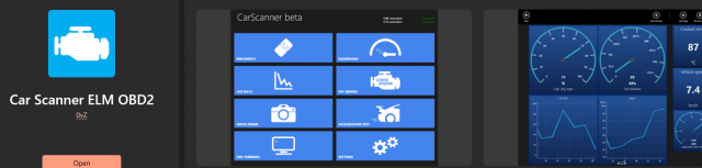

This one I use with the motorcycle and "Car Scanner" app. (Windows PC and Android Phone)
