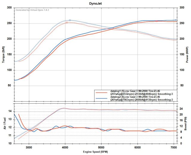

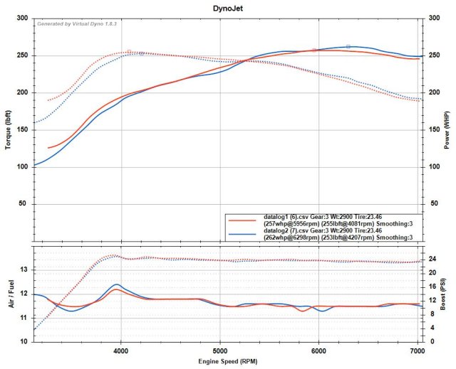

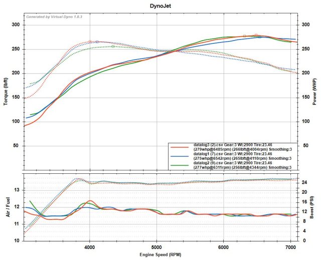

93 capped out right around 270whp. Could gain another 20-30whp going catless with no changes to the tune, but it feels good here. Dropped my catless downpipe off at Jet-Hot today for coating then will swap it when I install the thermal cat back, just a pain with no lift.
First pulls on ethanol below. Pump E85 sitting right at 72% ethanol content. Zero knock. Looking for a conservative ~320whp
