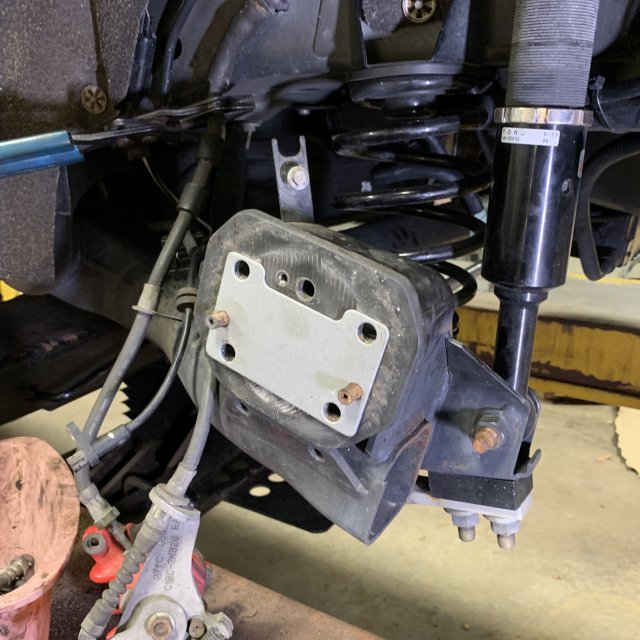

Yes. I contacted DNA before I put them on. You don’t have to shave anything or mess with your wheel speed sensors. You just don’t put your dust shields back on.
With the DNA Trunk Brace and Camber Plates, the Rear is grippier than ever before.

How hard is the install?
Jack up the rear.
Take your wheels off.
Take your brake calipers and rotors off.
Take out the 4 bolts on each side.
Whack the back of the dust shields till the hubs come off the pins.
Replace dust shield with Camber Plates.
Reassemble.

Awesome! Thanks alot! Did you order them straight from DNA's website?
Nope. I found a vendor here in New Jersey. He primarily deals with DNA’s Arbath parts, but he slipped in my Fiesta parts with his other order.
