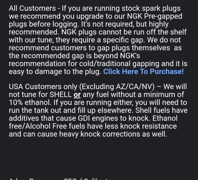

Received a custom tune file today. Making sure to read everything, I noticed the remarks about not using shell. I've been using their 93 since getting the car, even to mix my E30. Sharing new info (at least to me) . Should I use Sunoco? In bucks pa not really sure which to use now. I mean I put wawa in my daily...

Reading that picture closely, it seems that their issue is that Shell 93 octane is ethanol-free. They say they require minimum 10% ethanol for their tunes. That means they are depending on ethanol to keep their tune from blowing up the engine from too much heat in the cylinder. Ethanol has a cooling effect on combustion. It carries less energy than gasoline. It doesn't burn as quickly or easily. When you have more ethanol in your fuel, you can run higher compression ratios in a naturally aspirated engine, and higher cylinder pressures in a boosted engine (whether from compression ratio or boost). But if you tune for that and there is no ethanol, or even not enough ethanol, in the fuel, you will end up melting pistons and the like.
I live at Lake of the Ozarks, where boating is a big part of life, and super high performance boats are a dime a dozen. Therefore all our gas stations advertise the fact that their premium fuels have no ethanol because boaters don't want ethanol in their fuel. It destroys engines and fuel systems on boats, which causes problems from clogging of carburetors and injectors to boat explosions, because ethanol is corrosive to tubing, seals, and hoses.
It just comes down to what your ECU is tuned for and whether the fuel you use matches what it was tuned for.

They clearly delineate between the 2. They mention specifically the additives in Shell cause knock in GDI engines. This is a separate point from the non-ethanol fuels.
