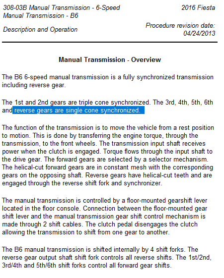

I doubt reverse has a synchronizer so this may just be expected from time to time.
Just a tad curious that it's been landing between gears more often lately.
Our terrain here is very hilly and probably instinctively roll it as I'm shifting into reverse... thinking about it, that's exactly what I've been doing. There have been times where I've already been rolling it backwards and had to brake to slow down before engaging reverse.
