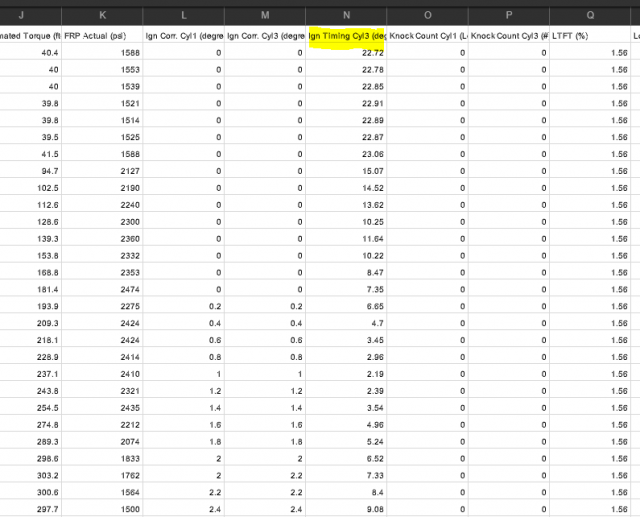

I recently upgraded to a depo racing fmic. Prior to this I was already running a dizzy e30 tune and the car felt great. After installing the new fmic I feel like the car lags a bit, and doesn't feel as powerful. I know the Cobb est hp figures are inaccurate but before the fmic the numbers would read around 190 hp or so. Now theyre at 175. Im still pushing the same amount of boost and I don't believe i have any leaks. When I load the stage 3 Cobb ots tune it reads almost 200hp. Could there be something wrong with my tune? I don't have any neg corrections but I noticed the positive corrections wont go past 2.50 degrees on the e30 tune but on ths stage 3 tune it runs to 6.00 degrees. Shouldn't the dizzy e30 tune make more power than the stage 3 Cobb tune?

Good deal, Jason resets the OAR learning to -0.65 when you reflash and you have to do a few pulls to get it back up to a perfect -1.00 so it always good to show OAR learning ratio on your AP and only compare after it's been at -1.00 for a while... and to touch upon the added timing, Cobb and Stratified use lots of *added* timing while Jason likes to use more *base* timing and add on less, so it's the total timing that matters... If you get all nerdy like I do, I take datalogs for an e50 tune I'm helping another tuner refine and after I send him the log in my Gmail, it shows under the sent message it all formatted on a table and I can look at all the data, pretty cool... So if you were to compare the e30 and the pump tunes total timing like shown, the numbers will likely be similar as they include a total of base timing plus added correction timing.
