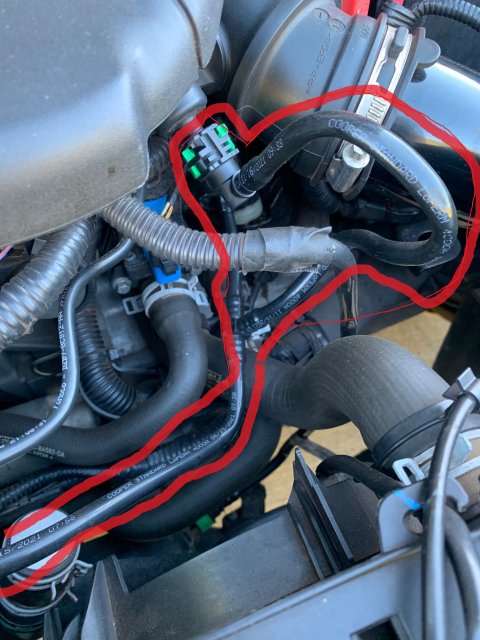

Gotcha, I'm having this issue with mine. It even stalls while coasting (in neutral) and does the post-refill clicking, so I have to fix it asap. Could you do me a favor and highlight what exact line I'm supposed to replace? Since it's best to look at it to determine what part I need, I could use some direction cause idk what I'm looking at lol. Appreciate it!

#34
Best case: see the photo and part number in my Post #24 above.
Yours looks a little different from mine, but it may just be the angle, etc. I've marked the part on mine, and my best guess on the part on yours.
