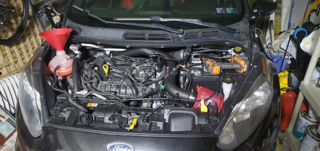

@Aeromoto sold me a crate o' FiST a while back. :) Finished the install late last night, only had time to run it up the road a mile or so and back before I went in for my 5th shower in 2 days and collapsed. lol... Tonight I'll put the hood back on when @DRVIPER711 gets back in town (I took it off alone, but there's no way I'm getting it installed and aligned alone) and I'll check it over more thoroughly. I let it idle for about 15 minutes before I drove it, no fluid leaks I could see at the time but it definitely idles low now. It also fell on its face somewhat on acceleration, but a) that engine hasn't been run in over a year, most likely, and b) the battery was disconnected for several days, so I assume it needs to relearn a bunch of sensor inputs. I also have a Cobb tuner that I haven't used on it yet since I knew it was getting major surgery, lol- I don't know if installing the new tune will force it to reset some parameters anyway. So, good news, it runs with no CEL and no obvious major leaks. Bad news, the idle was low enough to flicker the lights (that did seem to improve after I drove it that short distance, so may just have needed to remap its throttle calibrations- I was so tired I didn't stick around in the parking lot to watch it idle) and it stumbles on acceleration, which could be a calibration issue or could be a boost leak somewhere, last time I had it apart to replace the clutch it had a slightly loose hose clamp on the charge pipe that I didn't notice until I was on the highway.

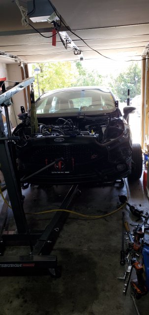

I did manage to squeeze the whole engine and transmission assembly out and in without pulling the front end off, so that was nice- I had the hoist chain as short as I could get it and the lifting strap rigged to be very short as well. I lifted from the passenger side mount and a bolt I put through the bracket at the back of the valve cover on the driver's side, it doesn't have anything that bolts on there but it is a fairly sturdy bracket. I couldn't use a load leveler because of the height restriction imposed by the ceiling, but it juuuuust barely cleared with the front end up on jack stands. 20200906_193814.jpg 20200906_215910.jpg 20200907_113517.jpg 20200907_203520.jpg

Would you mind giving a little close up for where you grabbed onto to lift it out?
Did going out the front work well for you? Looks like you cleared the ceiling!
So I don't have a great picture of it, but there is a black bracket on the driver's side rear of the cylinder head that has threaded holes and nothing attached to it, that's what I lifted the driver's side from. Passenger side i just looped the lifting strap around the mount since I was pulling that as well, I replaced both upper mounts with the considerably younger ones from the replacement engine and put on the black mount insert and ARP bolt for the passenger side.

Update, coil on cylinder 3 was intermittently failing to spark, likely it just wasn't seated all the way but I swapped on a known good one anyway and all is right with the world. Threw the OTS Cobb tune on it and I'm pretty happy with my work right now- waiting to make sure nothing shows up in the next week or so to make me doubt that. Lol
