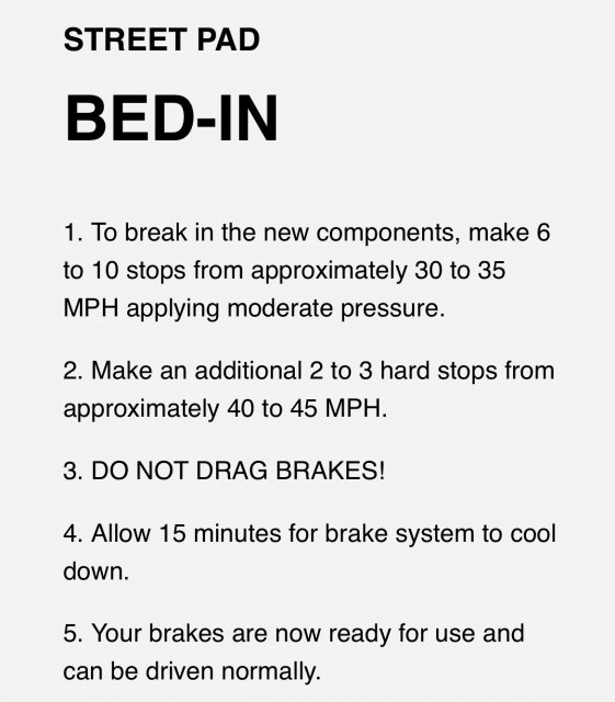

I just put all new front and back HP+’s on brand new oem equivalent front and back rotors yesterday. Firstly, I think this bed in procedure Hawk has on their website seems a bit inadequate. Maybe that’s for liability reasons?
Secondly, these things are squealing like a 50 year old garbage truck. I’m not exaggerating. It’s unlike ANYTHING I’ve ever heard. Also, they felt pretty slippery and mushy. They might be starting to get better today though in terms of bite, but the sound is still CRAZY loud under normal ‘round town braking.
I may go out on the freeway late tonight and try and re-bed in the pads with some higher speeds and heavier braking. If that doesn’t work, I may try a different branded oem equivalent rotor? Thoughts on that?
If that all fails, I think I’m going to try some porterfields
Its not the rotors. Ive run every pad under the sun at this point with the cheapest/shittiest rotors i can find for track days without any noise.
I would re-bed the pads and scuff the outer edges to eliminate flash spots when they bond the friction material to the backing plate. Some times they can drag and squeal if that material is dragging the outer edge of the rotor face.
The slippery/mushy feeling is the pad compound compared to the stock compound. The factory pads have extreme cold bite while the Hawks do not.

Last night I went out on the empty highway and did like 15-20 nearly threshold braking runs from 80mph down to 20mph with the HP+'s. Then I slowly rolled home trying to not touch the brakes at all and let it sit overnight. This morning I would say there were noticeable improvements in feel and squeal, but not enough to totally satisfy me. The feel and bite was definitely better so the more aggressive bed in runs I did were helpful, but they still squealed under normal to light braking
As a result I pulled apart everything later in the afternoon and greased the backing plates. I did a thorough brake clean and added grease to all caliper parts and backing plates. I also gave the rotors a quick mist of permatex brake quiet.
This all seemed to help a great deal. The bite is better and the squeal is gone. Time will tell if the squeal returns. I would think if the squeal returns soon, the permatex rotor spray was what band-aided the squeal. If they actually stay quiet, I'll think it was the thorough clean and greasing that solved the issue.
I was looking forward to seeing how they would hold up in a race, but my RallyX event was canceled this weekend. Regardless, I will keep y'all updated on how or if this progresses.
I will say though, that while todays clean and grease has made a significant improvement, even if they don't regress to more squealing I'm still not overly impressed with the pads. If the the work I did today remains, I'll ride them out, but would probably try a different pad the next time around. If they get squeaky again in the next few days, I'll be moving to the Porterfield R4s asap.
