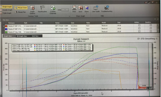

No the "411whp" (lol) is at 28-29psi per the video. Really hard to hear since the background music was so loud.
ahh whp, dam that thing is getting 465+hp wow! 80-100hp more than me, $1900+, r&r s280, plus tuning...will see
regarding build path i have aux fuel to get close to 400hp, I would still need hpfp/injectors if i want more than that

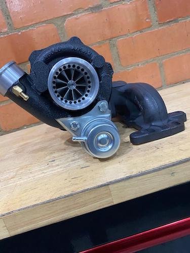

Something I went looking for as part of the kit is the turbine to downpipe connection. The video doesn't really show what is used. I'm assuming there is some product you need to buy, and something available that puts the output in the stock location for normal market down pipes?

there is a downpipe included with the BB kit
the video of them hitting that number is on a factory intercooler to avoid pressure drop. that coupled with the lack of communication with the tuner has me hoping there is more information we can get with the BBT as I would love to see if anything can be modified to change power delivery.
@juan@bigboostturbo has the BBT done anything new with the Fiesta ST since your original post? dyno'd with a bigger intercooler? adjusted the timing to delivery more linear power sooner in the RPM range?
any info you could provide would be a big help!
