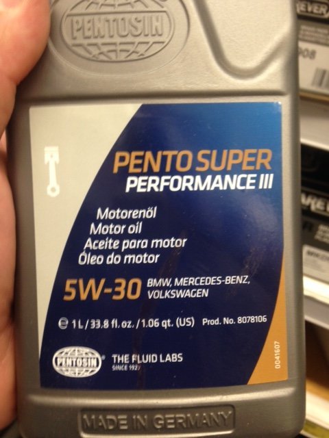

any thoughts on this, Its meant for high end bmw's still on the fence on going thicker but to be honest i don't like the sound of the di engines to noisy for me and still haven't gotten use to it. so i was also hoping it would make it a little more quiet other reason is i can get it for the same price of mobil one or actually a little cheaper.
Sure why not? Alot of others run 5w30 with no issues seen yet. If you wanna try it go for it. It's just like any other boutique oils out there plus or minus a few additives.
I run plenz plat 5w30, year round, no issues

NICE I am currently using the 5 20 penz plat so I can definitely go thicker
Penz plat is on the thinner range of viscosity levels, which is why I run their 5w30; It's more like a "heavy 5w20".
You can definitely run any kind of 5w30 without issue, as the FiST sold in other countries uses that spec oil.
I find the engine a tad quieter with 5w30 and a tad smoother.
